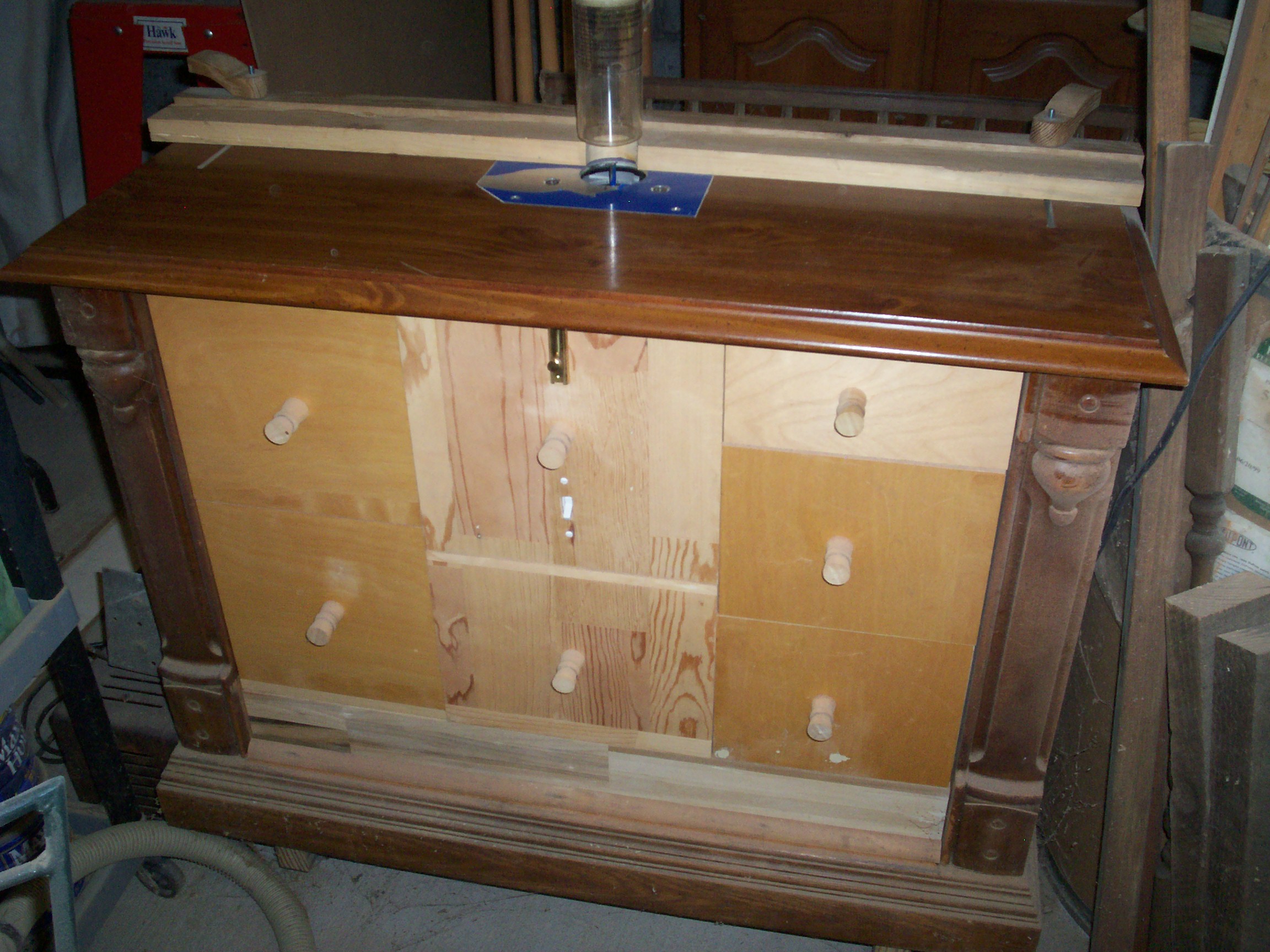

                  Luckbox,
                  Here is my Sylvania TV router table. It works great for me. Not built for looks.
                  The drawers are very handy. If you would like more pic's just ask
                  Hope this helps 4est
