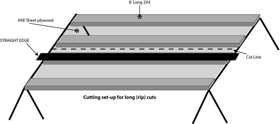

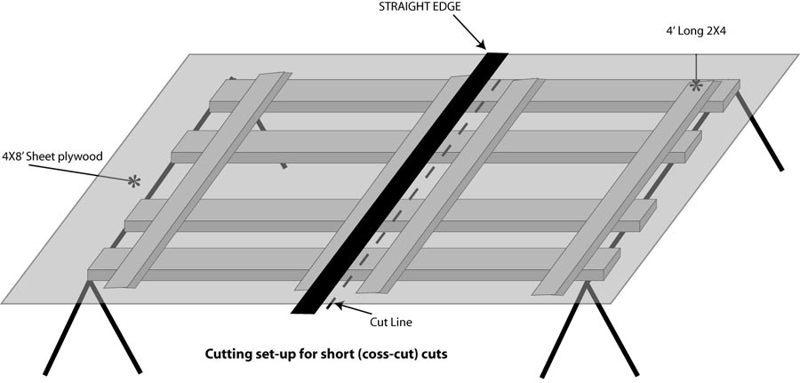

                      Rob,
                      As promised, here's the diagrams for ripping and crosscutting sheet-goods using 2X4's.
                      You need 6 2X4's, with 2 cut in half, the other left full sized. You'll also need a straight edge that slightly longer than 8' along with 2 clamps. Lee Valley has one, which I use. Although I got it when I had a lot of money to waste and not enough experience to know better. It's part #05J50.01 and sells for $145.00. Yup, it's pricey, but I do love it.
                      Looking at the diagrams, you clamp down the straight edge and add the amount of overhang from the blade to the end of the heel plate of your circular saw. For repetitive cuts, you can fashion a jig to locate the straithe edge without taking measurements more than once.
                      It's important to use a "good" blade (I've found that Freud blades work great, also masking tape over the cut line to prevent chipping of the outer plys. I tape both sides, and always cut with the good side facing up.
                      All this sounds way harder and longer than it really is. See the diagrams, it almost idiot proof.
                      If you still have any questions, PM me.
