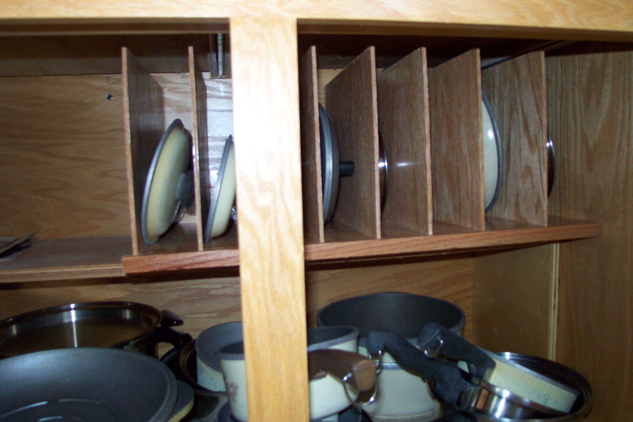

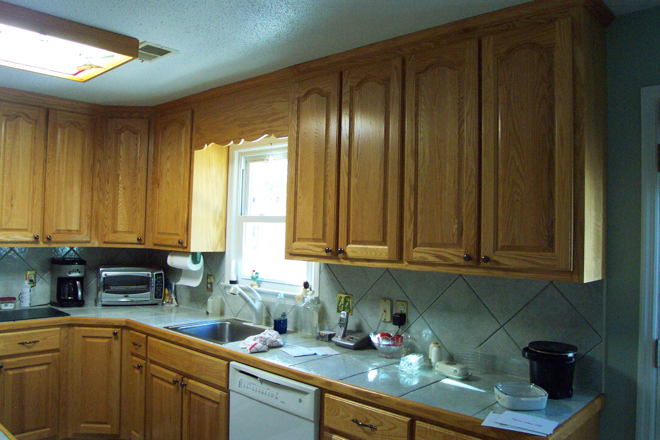

                You could also make a pan lid holder like I did for my wife. And the wall cabinets could be 42" tall and hang near the ceiling with small crown moulding around the top like I did.
