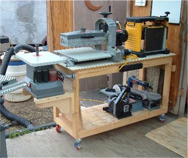

    Don't know of a cheaper alternative for a lift system that I would recommend but I have 4" Darnell Rose total lock casters on the front of my planer/drum sander cart with non-locking swivels in the rear and have no problems with movement.
    BTW, the loaded table weighs in close to 400# and rolls/steers easily.

        Sorry for straying a bit from the topic but nice setup Pappy.
                              [ATTACH]15807[/ATTACH]
                              Great idea, Pappy. That looks like exactly what I need to do. The lower shelf you have the spindle sander on... How high is it? Does it's height work with the other tools, such as the scroll saw?
