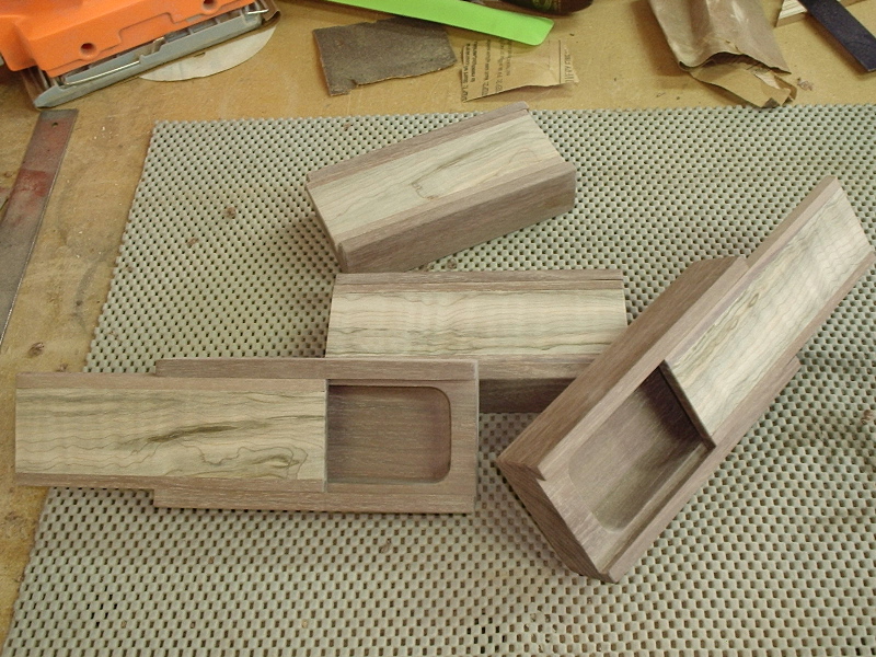

          Here is a pic of the boxes in question. They're made of walnut, with walnut lids with quilted maple inlaid veneer.
          My anxiety is that if I get the lids to have a perfect fit - easily slid, but not loose - a topcoat other than wax will screw up the fit. Am I just being anal retentive?

            If they're that tight, how is a change in humidity going to affect them?
            I think that finishing them as Sarge described with the Watco oil would work well and look good. You don't have to build up a thick finish with the danish oil. Just wipe on a couple coats with an applicator then wipe it with a clean cloth to avoid any buildup. After it's dried well an application of wax should help the tops slide easier too.
            If they ended up too tight a few passes with some real fine sandpaper on the top edges and a quick application of wax should take care of that.
              Ditto what Erik said. You could leave them natural but.. that spalted lid and main wood is not going to look as nice unless it is popped with something. Just try one box to see what happens if you are concerned as obviously you are. If it goes astray you can remedy the one as Erik stated. But.. I personally don't think there will be a problem but can't guarantee! Now.. you could line the slip groove wtih blue tape and leave that natural but.. you would certainly improve the looks over-all by popping that grain with at least an oil. Just keep the beads that will appear wiped in the first few hours with a clean cloth as once you wipe it originally any excess in the pores will come back to the surface. It is important to wipe about once every hour or two for 4-5 hours or the beads will set and cure.

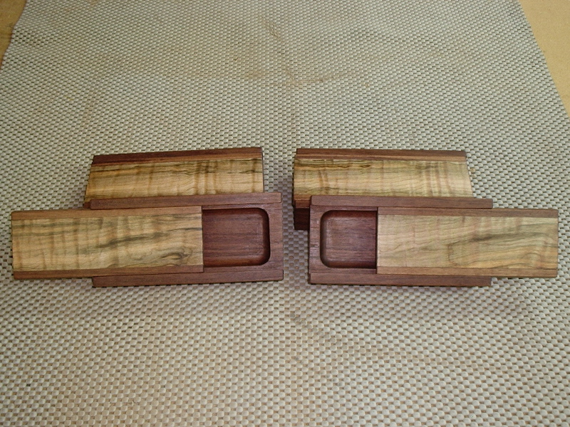

                Well, I went ahead and put on a coat of BLO. I'll report the results later.
                  Here's the finished result.
Name:	Sliding dovetail boxes.jpg
                  I used a couple of coats of BLO and then paste wax. I have used a lot more poly in the past, and I think the plastic buildup of that kind of product would have been a mistake re: the fit of the lids.
                  These have a nice satin look and feel, perfect for a small box that will be handled a lot. The grain pops (more than can be seen in the pic) due to the BLO. The wax gives the nice feel.

                      Those turned out real nice JR. The oil did make it pop.
                      How are the lids fitting? like the way you wanted?
                        Yeah, i have to be happy with the result. One is loose enough to fall out if held upright, but the others are just about perfect.
