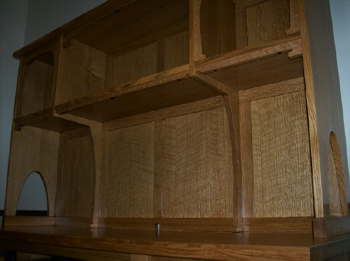

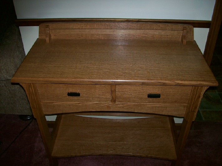

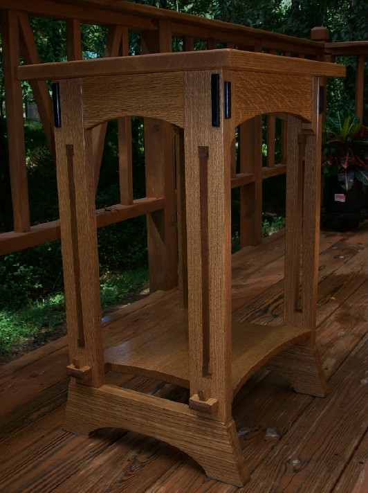

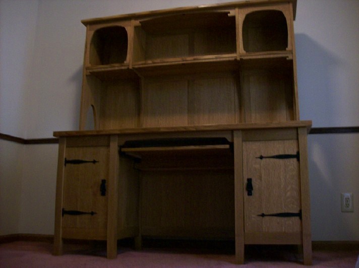

                          Here ya go Rad... I am simply going to post a couple of pictures from two projects I completed within the last 6 months. I have the current crochet-lamp table in clamps at the moment even though the finish has been applied. Still had to add and glue the inner frame between the top strechers which the tissue box tray is attached too. Long story on tissue box trays.
                          One is a fish tank table for our Beta.. it has the four coats mentioned as some water drops occasionally get splashed adding water or feeding. The other is a printer-shredder table that has a printer on top and shredder on bottom. This top has only three coats. Computer desk-hutch with 4 coat top as it sees a lot of traffic daily.
                          So.. you can judge for yourself as both these see activity daily and one is exposed to water. BTW... I use Min-wax Satin and then break that sheen down a hair with a rub-out with Renaissance Wax which get applied with 0000 Liberon steel wool. Kills two birds with one stone using the 0000 to apply the was... simply be sure to allows apply with the grain and not rotary as you can car wax when applying.
