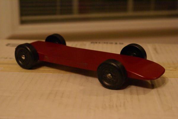

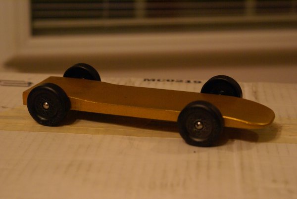

                      • 2809
                      This is a bit old, as my son is presently 40! But the car was a winner with a couple of first place wins in the pack and then a second place win in the final.
                      No tools at the time except my old RAS and some hand power tools. We drilled the pin (axle) holes in the block first, using a Portalign drill guide and then shaped the body with a rasp and then some hand sanding.
                      The pins were put in the hand drill and polished. The wheels were deburred and we used plastic-compatible oil (model train lubricant). The weights were added to one or two holes bored in the bottom and then taped over and painted like the body. Paint was Testors metal flake, and the little wind screen was a piece of plastic divider from one of the little hardware drawers. Pins and wheels were mounted last.
                      I took these photos a couple of years ago, when we discovered it in the old desk. My grandson now has it.
