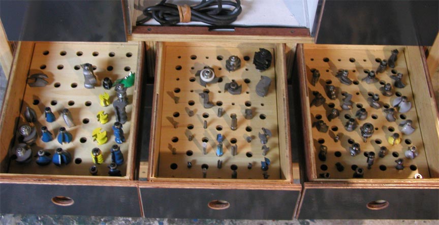

    I use 3/4" material with holes drilled to place router bits. The trays are about a foot square. I use that size as its easy to handle and it fits a toolbox to take on the job.

    The drawers on my router table are 4 inches high and that just covers the big ones. The sliding sections would be helpful for the shorter ones and a 5 inch drawer for my setup. Below is a picture of about half of my bits, with several larger ones missing from the left drawer. (The other half are in the States.)
