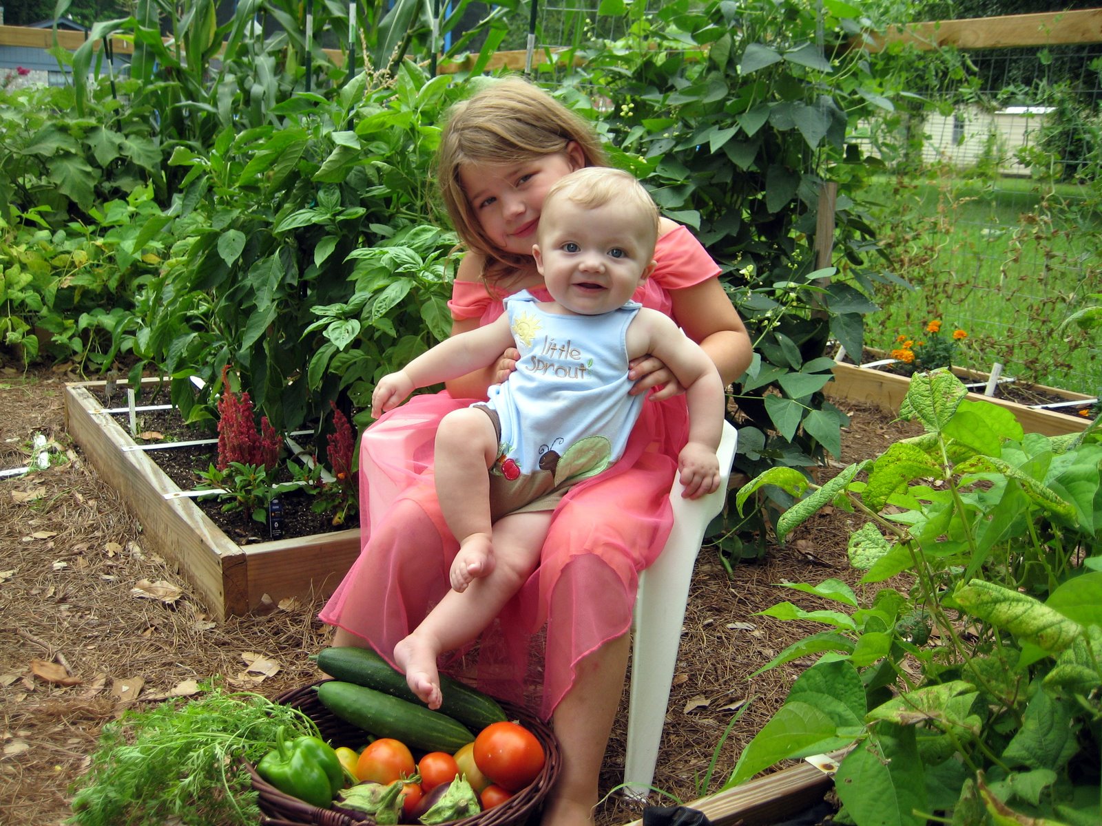

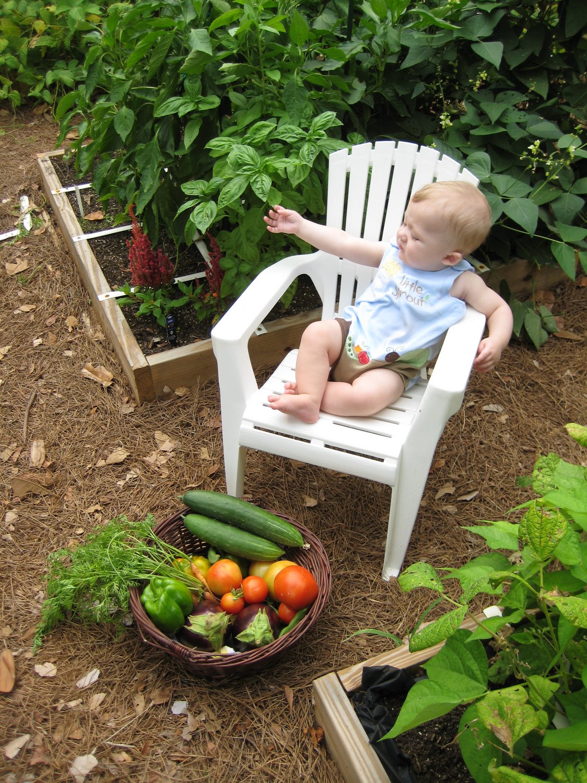

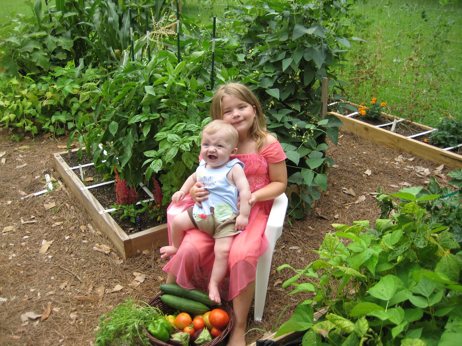

    I followed Mel Bartholomew's book - All New Square Foot Gardening and had great success last year. I used 2X6 pressure treated. I did extensive research on modern pressure treated wood which uses ACQ instead of CCA. I found that ACQ is safe to use in a garden, although getting a litigation-wary company to unequivocally state this would be difficult. I would encourage you to do your own research.
    I used exterior glue and 3.5 inch screws to butt join the 2X6's together and it's plenty strong without any reinforcement. I considered using 2X12's to obtain a deeper box, but it would have just entailed more expense to no real purpose.
    I've attached a few pictures from last summer. If you look closely, you can see how I fastened the corners together. The boxes in the center of the garden are 4'x4' and along the fence are 1'x7'.

          Wow, Chris, those planters are great, the harvest looks mighty tasty, but those kids are the ones who really make those shots! How adorable!

                  Thanks for the comments about the garden and my children. You did a nice job on your garden as well, and little one is mighty cute, too.
                  My daughter showed great interest in our garden, to the point that she took a bean from one of the plants, planted it in unimproved soil in the middle of the pathway, and it grew up to be a large and healthy plant. Too late in the season to produce, but she was very excited.
