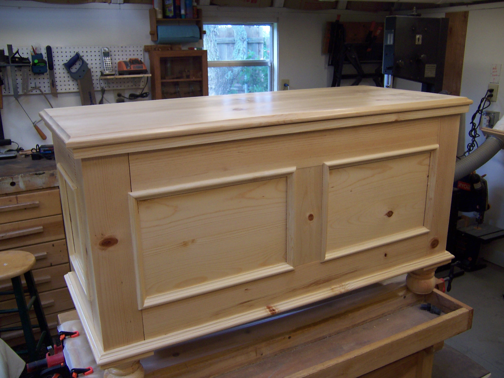

      Chopnhack, This is the one I built with rails/styles and panels. I think this is what you are thinking about building.
        Yes, Larry that is the style I was thinking of. Awesome shop by the way - so the question was on that style of chest, would dovetails be out of place? I am curious because I dont think I have ever seen a piece of that style with dovetails. Can you give me some more details on your build? How did you connect the adjacent panels? A tongue and groove joint or mortise and tenon or something else?

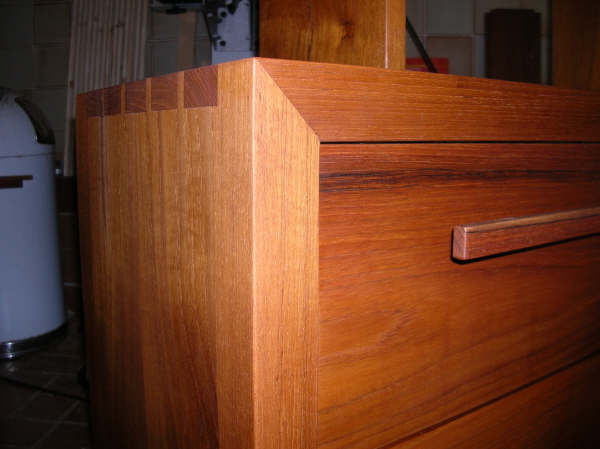

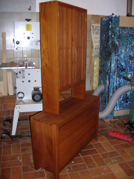

          There's no reason you couldn't use dovetails if you wanted to. Here is a set of cabinets my brother did last year on which he used dovetails.
          I would personally be more inclined to build a mortise and tenon frame. I'd probably let dadoes into the stretchers and posts. Another alternative would be to forego the dadoes and just trap the panels with a molding (it would look similar to Larryl's molding).
          Finally, you could just build the panels using rail and stile techniques, joining them together with dowels, pins, biscuits, etc.

              Sorry, I didn't answer your original question. I used rabbeted joints, I don't think strength is the guiding need in this type piece, it needs to compliment the more formal look of the panel construction. However, if your chest will be more a trunk then dovetails or box joint or some locking type jointery would be approperate. My $.02.
                [ATTACH]14861[/ATTACH]
                JR,
                How did your brother cut those huge DTs? I've done handcut DTs with
                mitered corners like that but none that big.
                  Originally posted by atgcpaul
                  How did your brother cut those huge DTs? I've done handcut DTs with mitered corners like that but none that big.
                  I'm not entirely sure. I know he has been working on his hand-tool skills, but working with him in the past he would have used a circular saw for quite a bit of the work. I think he used a combination of both. Unfortunately he lives far away and I can't spend time with him in shop.
