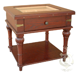

    Hi guys, and gals. I am in the very early stages of planning a humidor/side table. The table skirt will double as a humidor, with a single drawer to access the cigars and pipe tobacco. The top will be 1/4” glass, with a view inside the humidor to the hygrometer under the glass.
    My question is how would I begin to design the drawer to seal, the way a typical “chest” style humidor would? They use a Spanish cedar “lip” to make the seal when the lid hinges to the box. Or do you think another approach would be appropriate in this application?

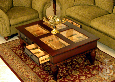

    I’ll try to attach a photo of something that I stumbled on just this morning. Mine would be a lot more rustic than these, but the concept is the same.

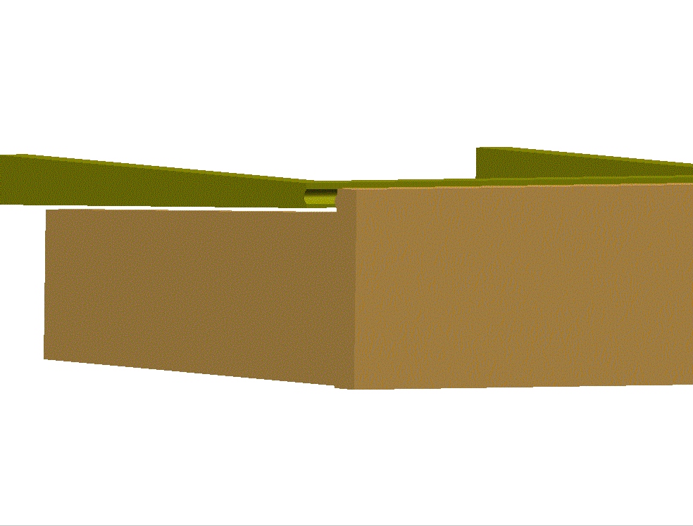

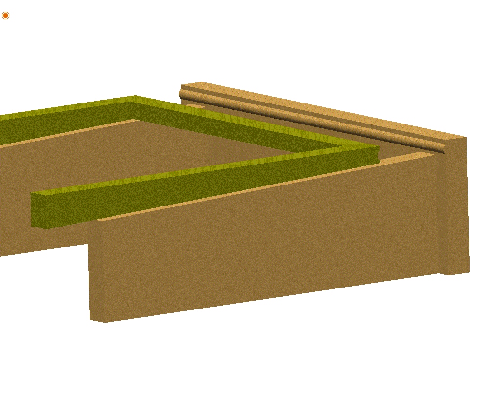

          I was pondering this over a Yuengling last night, and came to the simple conclusion that I need to build the drawer sides in 2 pieces. Make a wedge out of each side, where the top wedge is fixed to the table, and the bottom is the actual drawer side. It can be a very slight taper, but will allow the Spanish cedar to make a positive seal to the opposing piece. I would use oak as the structure, and rely on the Spanish cedar lining to make the seal.
          I can groove and chamfer the front to make a positive seal, too. Sort of like the way a stile and rail might fit, for lack of a better example.
          I think the split side concept could be a mesh of JR and Pappy's ideas. I can always follow up with some weather stripping if need be. Thanks to all who helped on this, and all who helped in the past. You guys really are a fun bunch.
          See if the models that I try to upload shed some light on my ramblings.
            I like it!
            You might want to think about some sort mechanical fastener to seat the assembly in the closed position, otherwise it would be difficult to get a tight seal.
