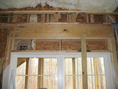

    1) I had originally planned to reuse the window header for the door header, since my original doors were not as wide as the window. However, now, my doors are 3" wider than my current window opening (72" opening, 75" doors).
    The header over the current window has two trimmer studs on each side. My step-dad said that I could just take one of the trimmer studs out on each side, and put double king studs on the outside, as long as I screw everything together well. I'm not sure if that's correct, though.
    I guess it really depends on what the requirements are for a 75" opening. Does anyone know if dual trimmers are required? Maybe the builder just added them to take up space, instead of actually being structural? Here is a photo of the current header:

      So, not that this is necessarily an authoritative reference, but this article indicates that anything over 5 ft requires 2 trimmers:
      http://www.rd.com/guide-how-to-build...le18202-1.html
      It also looks like it's right on the border between double 2x10 and 2x12 headers, so I should probably just tear it down and (hopefully) reuse it for the bedroom window.
      I guess that answers my 1st question...
        You need 2 trimmers. Also, when in doubt go bigger. Use 2x12s for headers.
          I would not do pavers as a shop entry. I would either do a ground-level deck or concrete patio as you had planned.
          2 trimmers it is, w/ a 2x12 header.

            So, any idea if I am going to be able to remove the current header and throw up the new (larger, 2x12) header without incident? It's an exterior wall, and I'm not really sure how I would go about temporarily jacking/bracing it while I put in the hew header. I can add extra king studs on the outside, I'm just not sure about the top plate. Would it be ok for a couple minutes while I took down the old header and put up the new?
            Obviously, I would have the new header built and ready to slap into place immediately...

              In your last picture, it looks like the framing for the floor above is spanning from left to right, parallel to the exterior wall. If so, and if that is also the case for all other framing above (additional floors, roof, deck, whatever), then this is a non-bearing wall and you shouldn't have much trouble.
              However, even a non-bearing wall must carry its own dead weight so when you kick out the props you are bound to get at least a small amount of settling. I would have one or two bottle jacks at the ready, and would cut all the studs and trimmers to the correct lengths ahead of time, so that when you get them into the wall and plumbed you will know that the header is at the correct elevation.

                You are correct, the load bearing walls run perpendicular to this wall, but I thought all exterior walls were load bearing (to some extent).
                Anyway, I will have everything cut and ready to install before I remove anything. I think my step-dad has some jacks. What exactly would I be jacking, though? Would that be to jack the header up back into place if the top plate sagged a bit?
