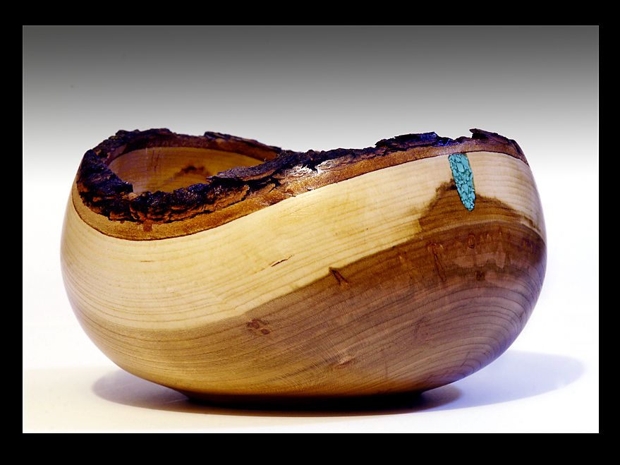

                  My neighbor, Layne, uses a mixture of Crazy Glue and turquoise chips to fill some of his problem spots.
