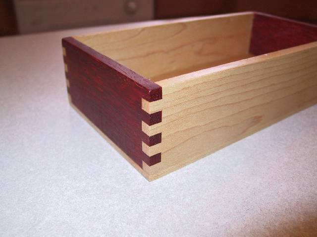

                I use it for contrast, or as an accent in small projects (a little goes a long way). But, then it's even more important to control the dust, as it can "smear" in your finish across lighter colored wood.
                This is a small box made of padauk and maple that I use to hold portafilter parts and tamper for espresso. It was going to be a knock-box (for grounds), but that's what a garbage can is for.
                Regards,
                [edit: Uh, in other words, exactly what "bthere" pointed out not more than two posts above Well, I showed an example, does that count?]
