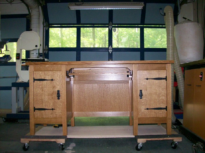

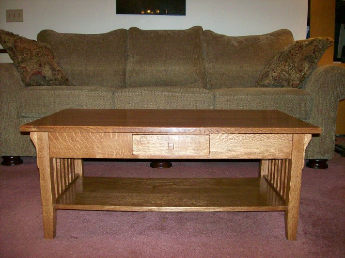

                Forgot something which I know is hard to believe with that long post. Here is a result of Mini-Wax mahogany gel on a mission coffee table and the desk (hutch almost done) with Bartley's American oak which is lighter. I don't use dye as I am a diaster with it (me.. not the dye) so I really don't bother with dewaxed shellac cost. Just something you can view on QWWO for future consideration if you like either tint on these pieces. If not.. disregard...
