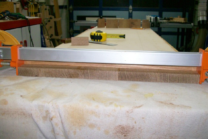

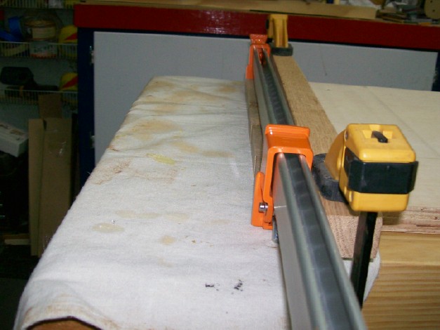

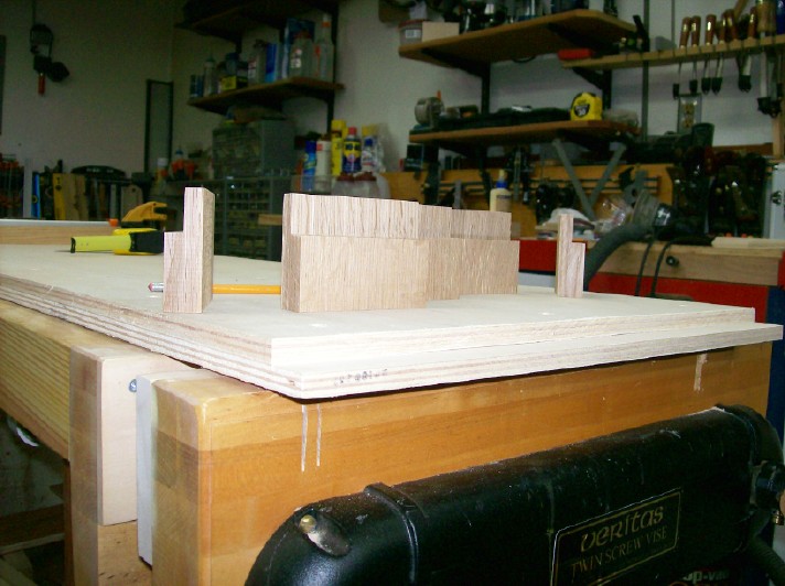

            Basically what my thoughts were when I did it yesterday, Bill. But.. I really wouldn't trust biscuits so I cut a 1/2" rabbet 1" into the end of the ply and then ripped some 4" wide QSWO. I rabbetted them to fit the ply rabbet and glued. Lots of glue surface there and should hold fine as you mentioned... the veneer will go over that even though I have been advised not to go that thick with veneer so I will use 1/16" and apply another 1/4" sheet of ply under the current to make up the 1/4" difference as ply is no truly 1/4".

                ...I cut a 1/2" rabbet 1" into the end of the ply and then ripped some 4" wide QSWO. I rabbetted them to fit the ply rabbet and glued.
                But, now don't you have essentially a 22" wide piece of cross-grain attached to ply? There's going to be a lot of differential movement, isn't there? Or did I misunderstand?

                  That piece is actually 19" wide Tom. I was going to add a 1 1/4" thick x 1 1/2" wide real piece of QS and spline into each side. But.. I think you are talking about the lower layer of end grain not matching the top veneer when added. I cut those end strips 4" wide and so is the veneer. I was hoping for a match but the more I think about it.. the lines in the end grain may be difficult to match exactly.. and they may move differently as the veneer is 1/4 which I have already decided is too thick.

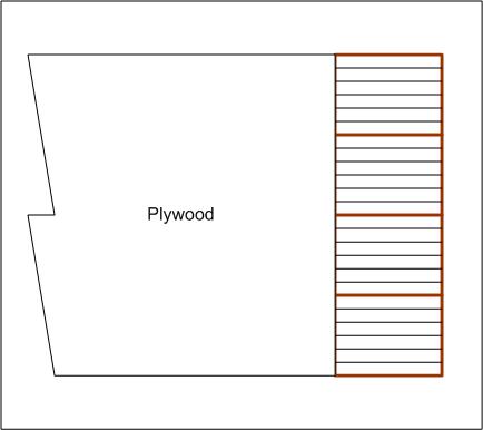

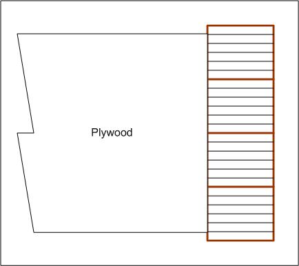

                          OK, I know the horse is dead, but out of curiosity, here's one more flog....
                          I pictured what you were proposing to do is add small lengths of QSWO which were edge-glued to give a width of 19" as shown (ignoring the 4" wide front piece of QSWO:

                          So, the differential wood movement (with changes in humidity) I was referring to was this:

                          Again, I may have pictured this wrong....
                          Regards,

                            Yep.. exactly what I intended to do before my senses took hold of my tight wallet and made it take a trip to my supplier for 30 more BF of QS. I just got home from there after purchasing another $120 worth of life expectancy insurance as I'm going solid wood. I'm just not taking the risk on that end grain doing exactly as you suspect (and I do too) it will.
