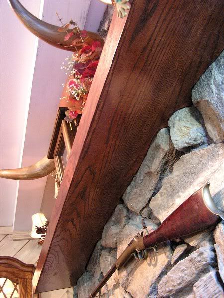

I will try and explain how the head guy around here did our mantle on an irregular stone fireplace.
Firstly, he used a piece of paneling as a pattern. Remember when everything was paneled in the old days? Well, we still have a load of it in the garage, and it sure has comes in handy many times over.
Here is how he did it.... He cut a piece of 1/4 " thick paneling --several inches wide and the length we planned on making the mantle. Then he cut a small piece of wood (think of a piece of wood that is the size of a nail file, only thicker) and drilled a hole a few inches back in that piece of wood --in order to put a pencil through the hole. Hold up the paneling to the stone and run your small piece of wood (with the pencil in it) along the stone (this is the scribing part) and the pencil will be marking the paneling as it follows the stone...thus creating your pattern.
Then cut the paneling following the pencil line and that's your pattern for your wood... (after you cut out the paneling pattern -- try it out for accuracy before you cut into your oak wood)
In our fp, because the stone is so thick we had to do this twice, once for the top and once for the bottom.
I'll get a couple of pics, hold on... JoannComment
