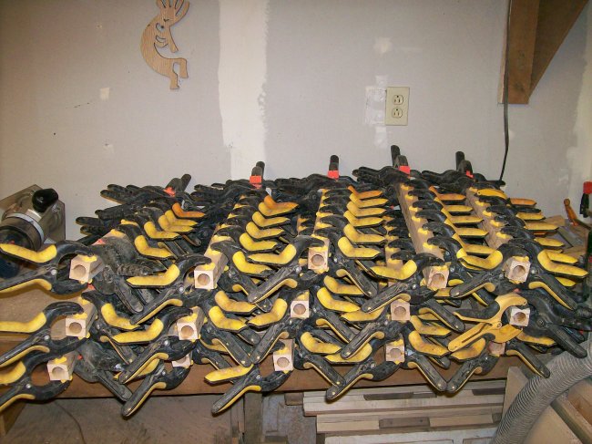

    i havent made many flutes(native american style flute) for a while now,so lately been prepping to get back to it, the way i typically make them is a 1.5x1.5x24+/-" blank split in half,fluted out with a core-box bit then re-glued. i'd use a whole bunch of spring clamps ,bout 8-10. it'd take every tiny clamp in my shop to clamp a few of them...

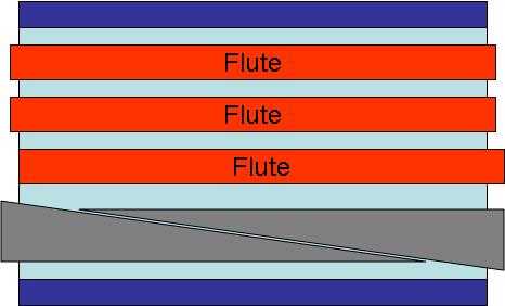

              I was envisioning building a clamping system using a Flat base(light blue) fith sides fastened at a 90 degree (dark blue) then after gluing the flute bodies together you would place the wedges against the other side and tap them to togther to create the pressure to set the glue. I would put wax paper on the base and between the flute bodies. Pressure would be applied by the driven wedges. Would work for a one at a time or a very small number probably not 2-3 dozen.

                p.s. this is exactly what my typical way of glue-ups looked like (not quite as neat looking since mine wer mix-match clamps)

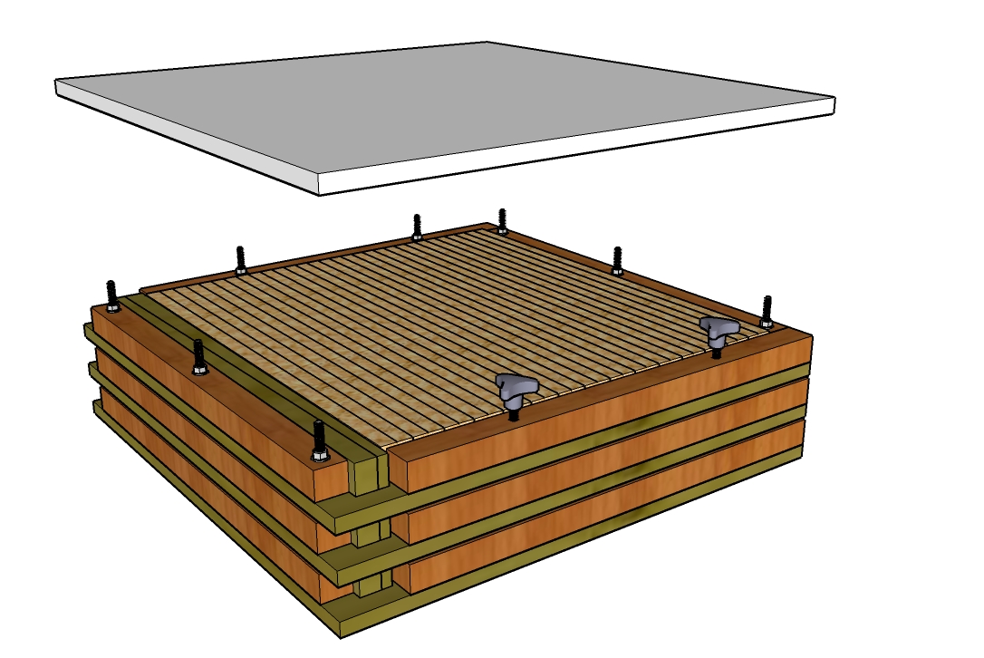

                  i've only used sketchup 2 or 3 times , but the more i do the more i LOVE it.
                  been a cad draftsman/designer for years using autocad,but this is just way more fun.
                  anyhow, here's mike's jig taken a lil further,
                  was having fun so i added in the thread red/bolts,nuts,washers,and star handle options. dunno if this is the way i'll go with the flutes but it's a neat idea, all the blanks would have to be perfectly equal size or might have misalignment issues...i guess a pieec of waxpaper top/bottom would keep it mostly clean of squeeze-out,which should be minimal with the roller application. anyhow. heres soem views
                  heres the link to the sketchup model

                    Dang
                    I was real impressed with my version of it for a quick concept until I looked at your drawing. Great design
                    Of course I have to admit I have had little to no luck with sketch up, after spending time with the tutorials..
                    how precise do the wedges/angles need to match to give equal clamping
                    across the full length? would careful freehand on bandsaw suffice?
                    I thinc they should be fairly accurate, since all of the clamping pressure will be generated through their contact. You may need to make a taper jig for sawing the wedges. Look at this thread for a jig http://www.bt3central.com/showthread.php?t=40110
