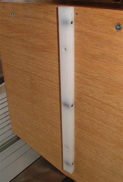

          3/4 x 3/8 UHMWPE Sled runners -
          Drilled/tapped to attach with 1/4-20 screws (counterbored).
          Sideways drilled/tapped for 1/4-20 nylon tipped steel set screws
          EASY to adjust - work perfectly
