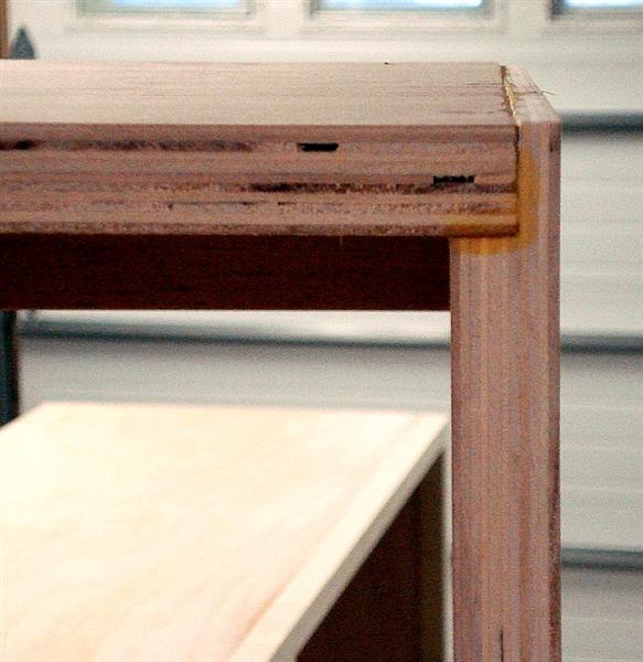

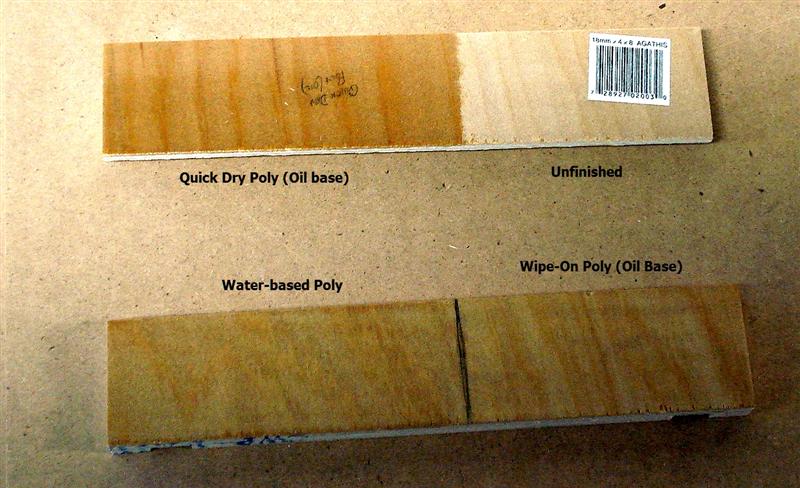

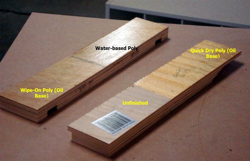

              I did a small report on Agathis some time ago, but I can't find the thread. I used it for building cabinets that were painted on the outside and finished with urethane on the inside. I found the plywood to be better that HD's usual stuff, but certainly not up to Baltic Birch standards and it did have some voids, although not large ones. It finishes well with paint and has a nice clear grain when finished with polyurethane. Agathis comes from New Zealand.
              Here are some pictures. Regards, Steve
