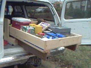

    Fine Homebuilding 189, pp. 30
    The Big Drawer
    I know truck-bed extenders are available commercially, but I decided to make my own to demonstrate my carpentry and problem-solving skills to my clients. It seems to have worked. My truck’s Big Drawer never fails to be a great conversation starter....
    From Fine Homebuilding 189, pp. 30
    September 1, 2007
    Rusty
    If I had more room, I'd buy more tools!

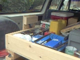

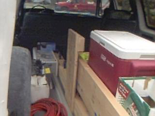

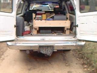

              • russd
                • Nov 2004
                • 74
                • SilverSpring, MD, USA.
                Sorry about the low res pictures.
                Rusty
