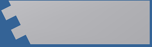

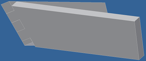

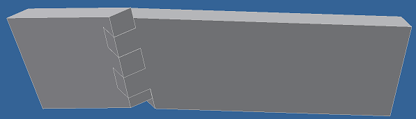

                    Lemme mess around in inventor and see if I can't figure out finger joints for a compound angle. I would rule out dovetails right now, unless you wanna put 100 hours of design into this project.
                    Edit- I just put a run of the mill box joint on two pieces that fit together for a compound miter. Perfect fit. I had problems with the top and bottom not being flush only because I didn't use beveled sides. I think that should eb easy to figure out.
                    the first two show the completed joint, and the last two are the two pieces I used.
