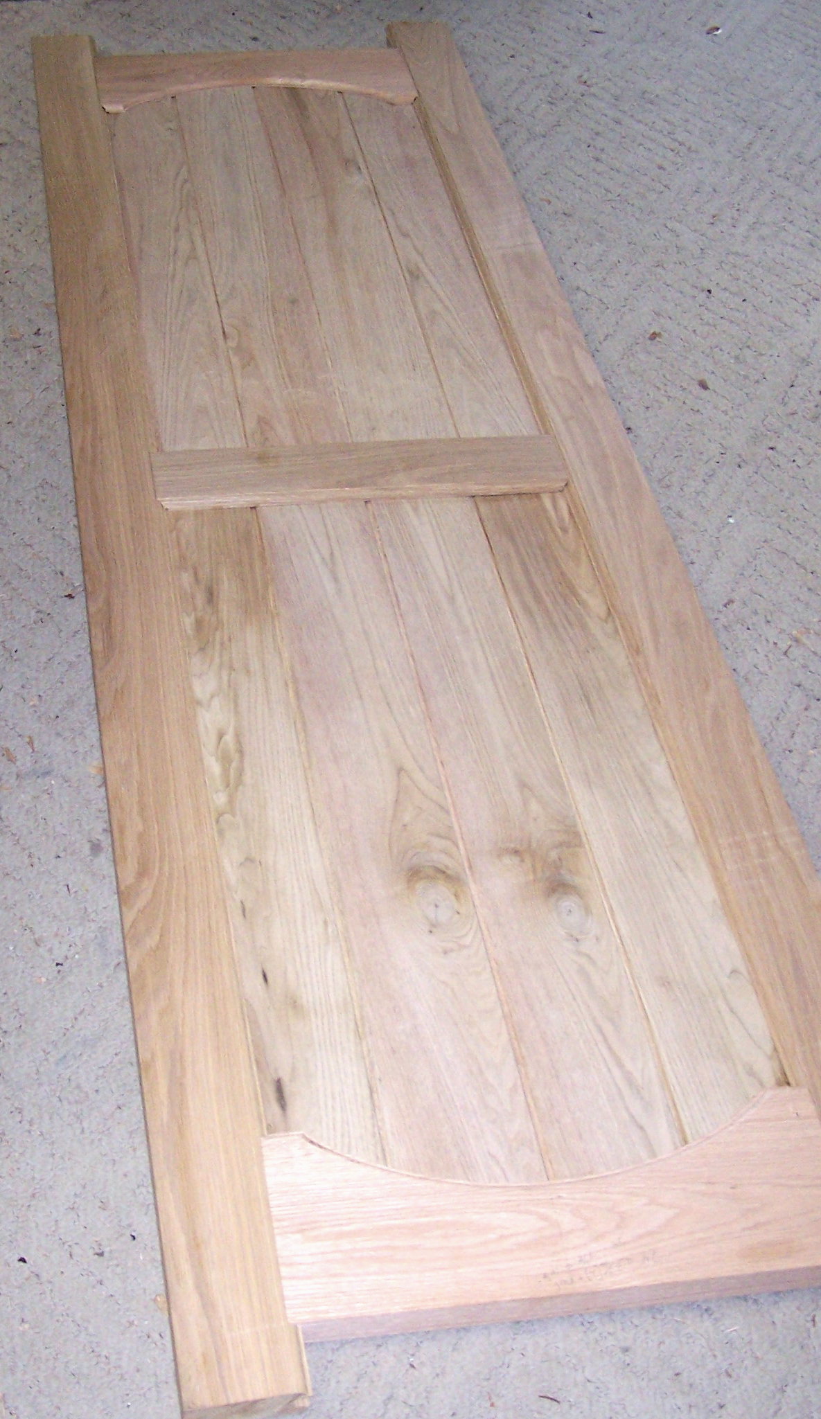

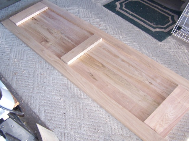

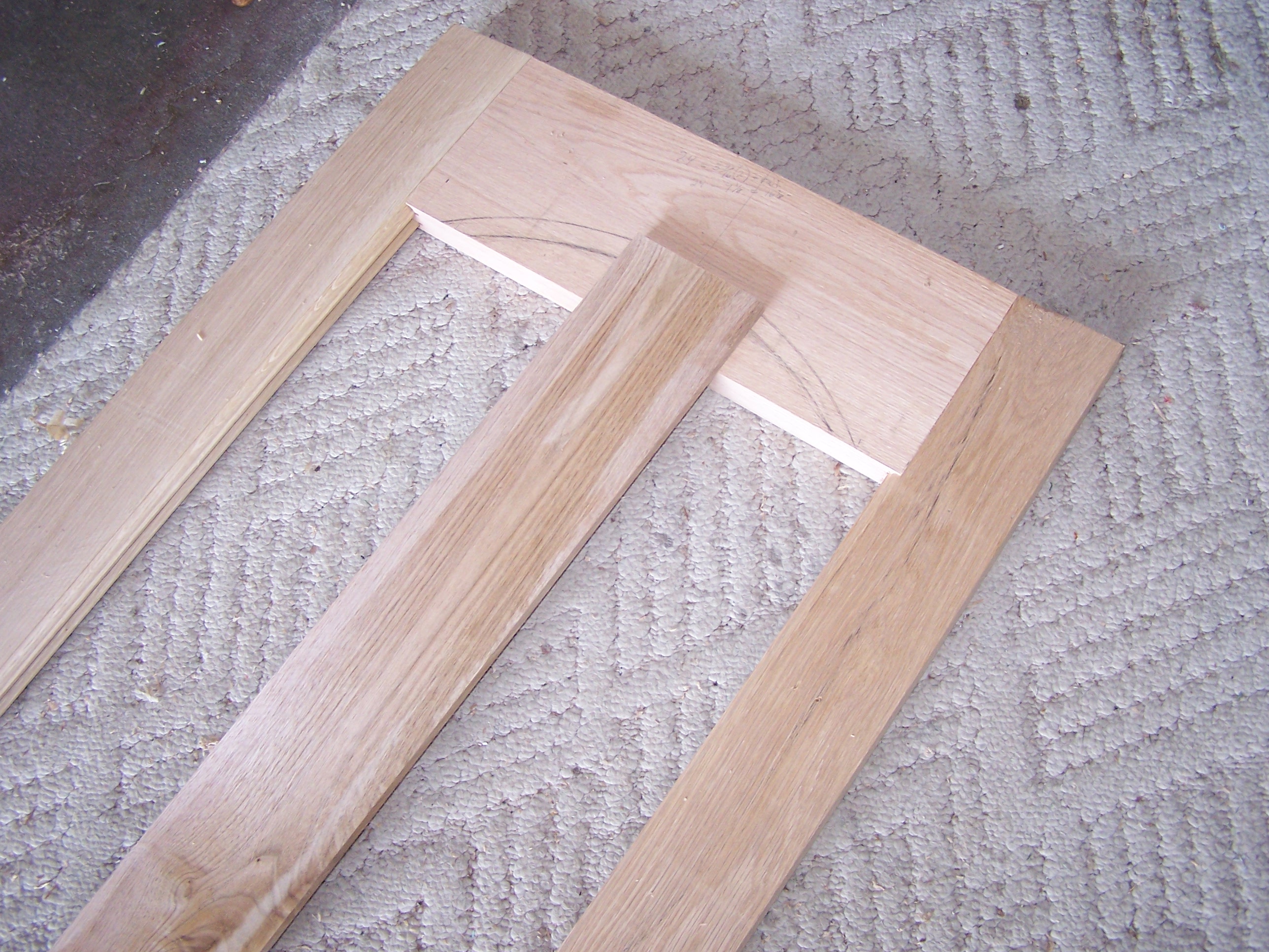

    My door is 24" wide x 80" tall. It'll be made with a red oak cope and stick frame and flat butternut panels with vertical beads. Here's a very rough layout of the basic parts loosely fitted just to get a feel for the dimensions.

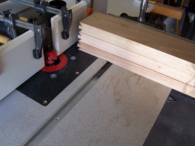

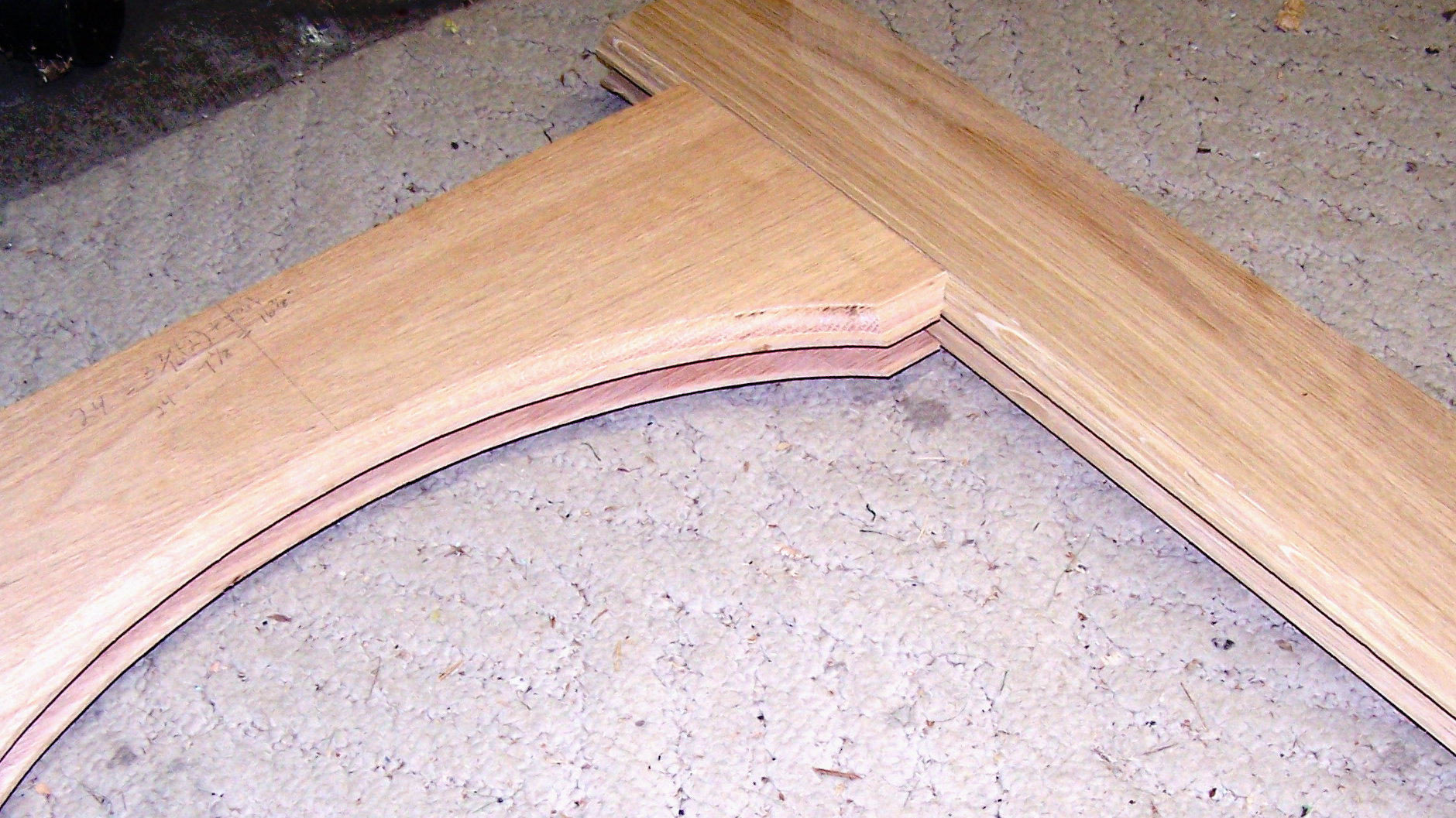

    Here's a glimpse of the 3 rails after routing the cope and tenon in the ends. The top and bottom rails will have arches, which I still need to rout the channel in.

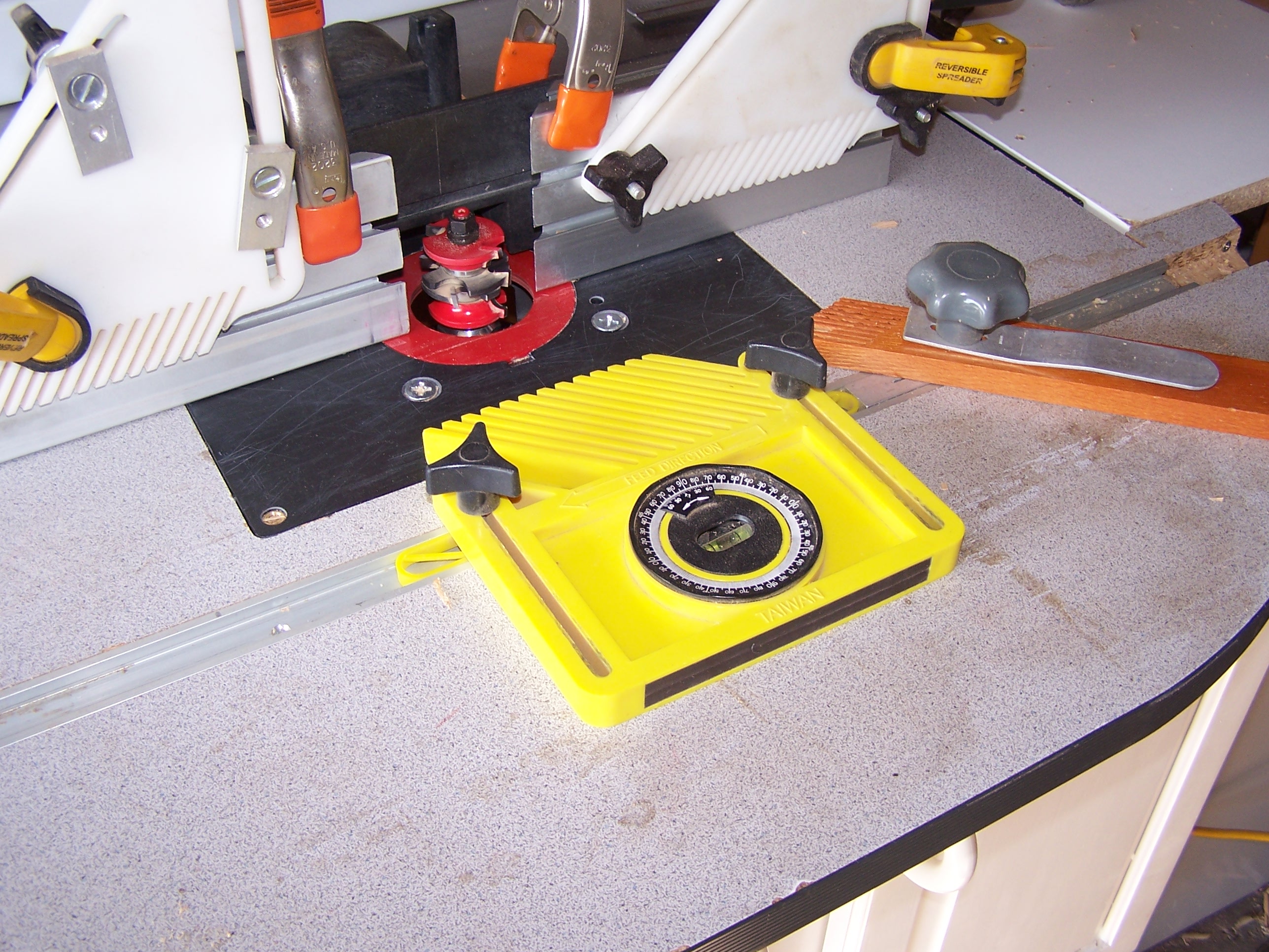

    The sheer size and weight of the styles requires the use of of featherboards to help keep the piece tight to the fence and table during the routing of the groove for the tenons and panels. It went pretty smoothly once I got going on it.

    Here's a dry fit of the rails and styles, as well as an attempt to get rough length of the butternut panel pieces.

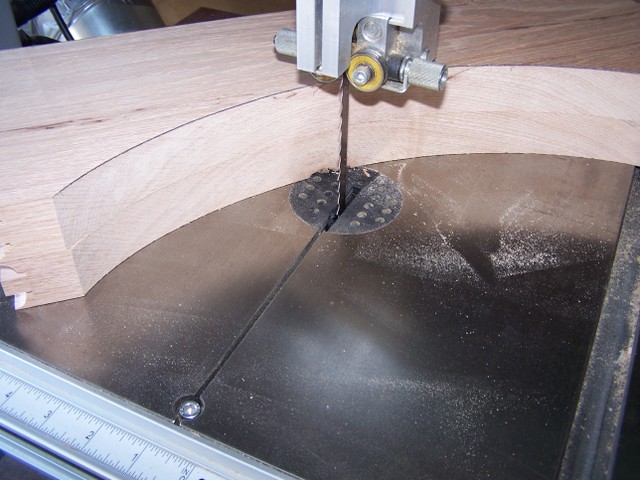

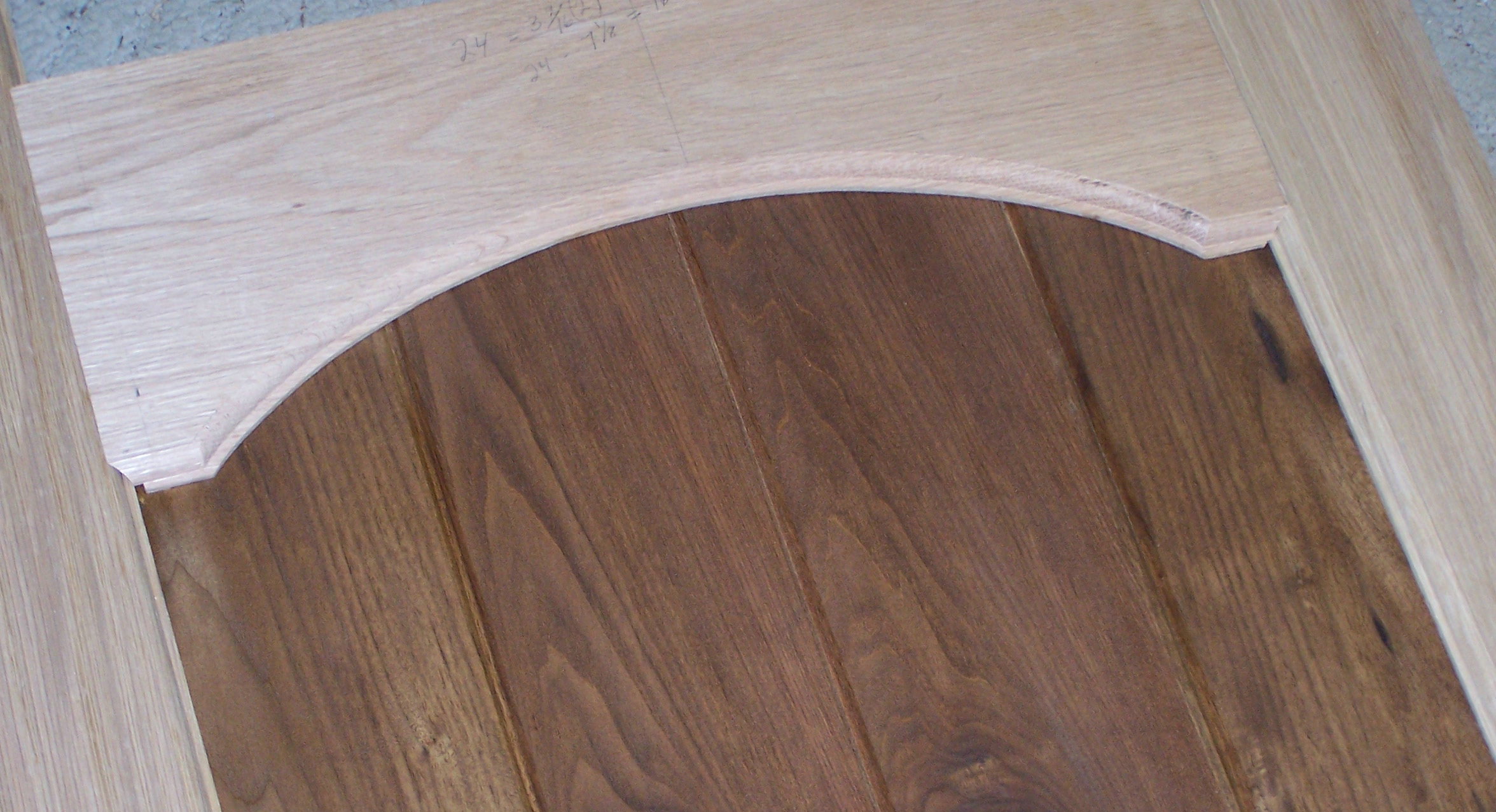

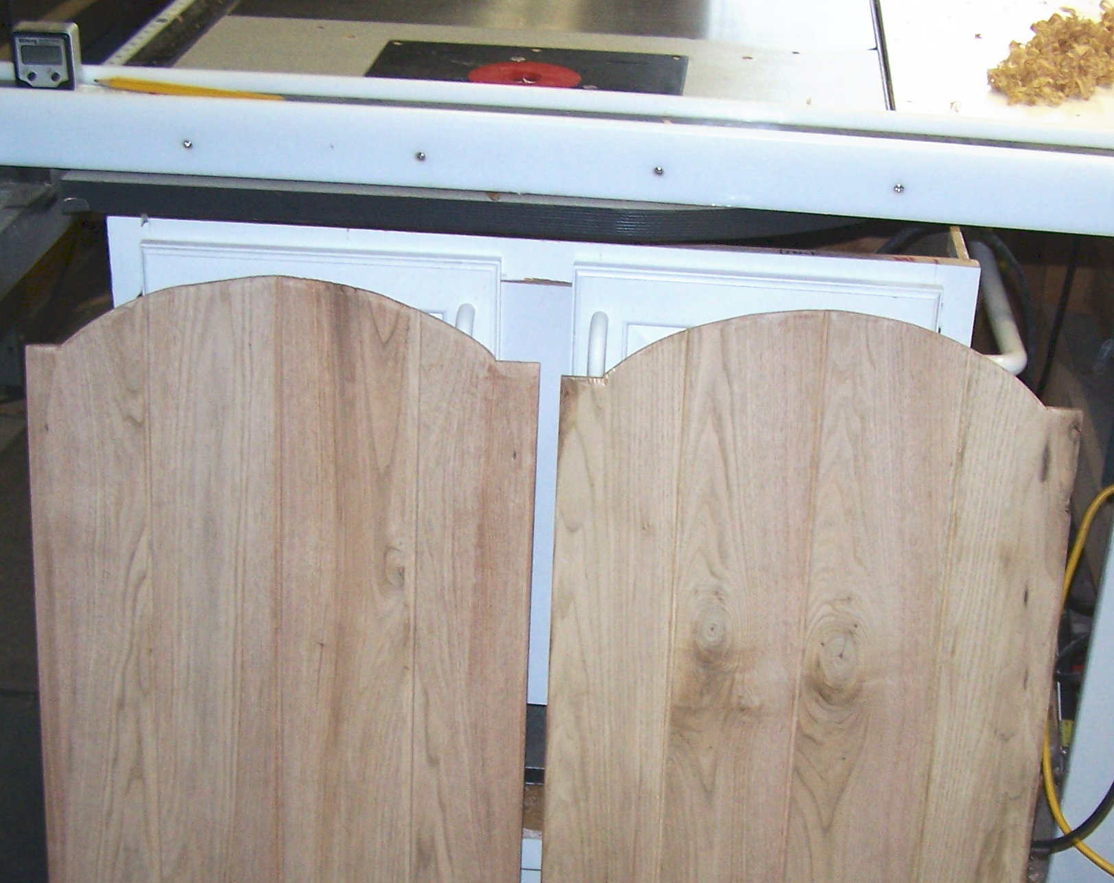

      Got the panels glued, and cut to shape & size, got the arches cut on the rails, tested the fit, got the panels stained, and am testing some colors for the frame.

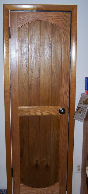

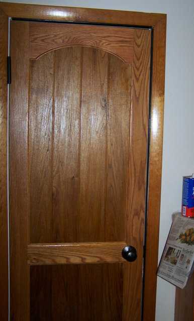

        Here's an update on the door progress.....almost done. It's hung but the weather gave out before I can put the finish coats on, so I'm in the middle of doing that. I'm also going to have to paint the inside of the door jambs. It should be finished by this weekend. I'll post the final pics then.

          WOW! I can't find anything else to say, I'm stunned! Just beautiful!!
          Blessings,
          Chiz
            That is a beautiful door. You've won either way, as far as I'm concerned.
            (But still crossing my fingers that you win the trip to Italy).
              Great looking door...
              • footprintsinconc
                • 1759
                • Roseville (Sacramento), CA
                just saw your post, that is one beautiful door! i certainly hope that you win the trip to italy.
                omar
                  Great job and a beautiful finish.
                  • bthere
                    • 462
                    • Alpharetta, GA
                    I will have to agree with everyone. That is a great door.
                    • tribalwind
                      • 847
                      • long island, ny.
                      beautiful door'
                      especially being a first !
                      it looks like the doorknob had to be located on a rail/stile joint eh?
                      best of luck with the trip
                      • Knottscott
                        • 3815
                        • Rochester, NY.
                        • 2008 Shop Fox W1677
                        Originally posted by tribalwind
                        beautiful door'
                        Yeah...first timer oversight for sure!
