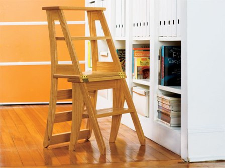

          Franklin chair
          This is one of my "I'm gonna build that one day" projects.It may not be practical for your situation but I thinks it cool.
          http://http://www.popularmechanics.c...html?series=20
          I hope the link works this is the first one I've tried to post.

                Ok heres the second attempt.This is a Ben Franklin design that can be used as a chair or step stool.
                http://http://www.popularmechanics.c...p/4226197.html

                    ahh. that is interesting. I'll have to ponder that one. its cool, but it may be a bit much for the intended purpose. I don't think she could move it around that easily.
                    I'll store the link just in case.

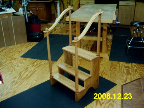

                      Update:
                      If anyone is interested, I never really found any plans for this project, so here's what I came up with. I took Thalermade's shaker stool link and modified it a bit. I made the whole thing wider (about 2ft total) and lowered the first 2 steps to 6". Then I made the railings for it. It was my first turning project for the spindles. It works, and my mother in law was pleased anyway.
                      Todd
