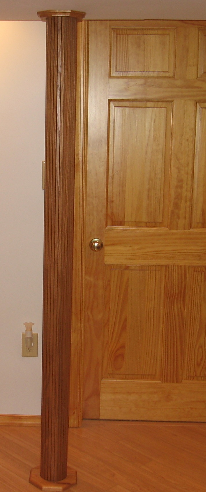

        This is what I used to when I finished out my basement this past summer. I bought this at my Lowes. http://www.lowes.com/lowes/lkn?actio...tt=pole%20wrap
        Imagine something like a roll top desk type of wood wrapped around the pole. You break each joint and bend it around your 3" or 4" pole. They are red oak slats and I stained mine but paint would work also. They also have base plates and caps to finish it off. I am happy with the ease of installation and the look. I can upload a photo later if you want to see what it looks like finished. I don't have all my rehab photos with me.
        -Shawn

              To attach the pole wrap to the post I drew a vertical line with my level and applied liquid nail to the line area, using the line as straight edge. After letting it dry fully, I applied liquid nail to the rest of the pole and attached the wood. To hold both sides of the seam I used a lot of passes of the blue painters tape. I have three boy and in the last 4 months it has not been taking down. The base cap is also held down with liquid nail.
              I have attached some photos of it installed.
