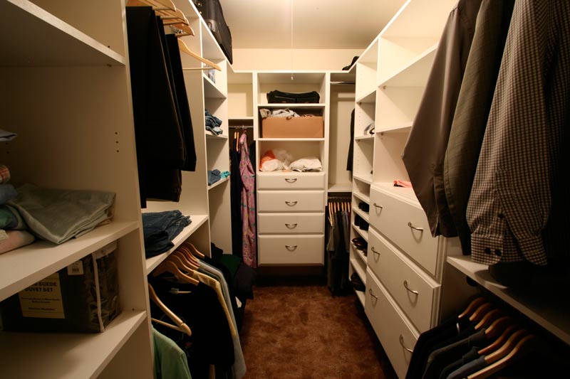

                  I did a closet project awhile back and was debating over whether or not to use Melamine. I wound up buying mine from Home Depot and everything turned out okay. Of course any imperfections were ultimately only going to be in a closet, but I was really happy with the way it turned out and would have been satsified if I had been working on a room wall. Everything in the closet below is Melamine except the drawer fronts and drawers (Poplar and Birch).
                  When making cuts I always did it in 2 passes which really helped reduce the chipping. The 1st would be about 1/4" deep and the next for the full cut. Pocket Holes helped me big time with the whole project (Picture 2). It looks messy in the hidden areas, but leaves a clean look everywhere else and worked great for me. I've been away from this site for awhile, someday soon I'll finally get around to posting these pics...
                  Anyway, I think the Melamine is definitely a viable option. One other tip: I have to thank EasyClosets.com because I used their site to design and visualize in 3D what my closet was going to look like. You might want to check it out because some of the dimension assumptions are the same. I kind of felt like I was using them, but hey it's free, and I'm giving them credit here... Good luck.

                    I'm really new to woodworking, aside from hacking together junky shelves in the basement once or twice so I'm curious. What's the wood strip for that's screwed into the wall along the top of the cabinets? Is that some sort of level indicator or what?
                      The wood strip is there to help secure the units to the wall. Where possible, the top shelves are secured to studs using a pocket hole screw drilled through the melamine. Since this is only in limited places, the strip is mounted to the studs and runs tight along the top shelves, then the pocket hole screws were drilled down through the strip into the top. I don't want to hijack Marc's thread so I'll try to start a new one on this when I get a chance to post more pictures.

                            Just one point of clarification for those of us who are not as experienced as others . . . .
                            The pocket screws are a good way to hold the cabinets against the wall, but are they enough to hold the heavy particle board cabinets up? The photo doesn't show if there are cleats inside the cabinets or if the cabinets are resting on the floor or on bases that aren't apparent in the photos. If they are, then the pocket screws are, indeed, a good way to hold the cabinets against the wall with the weight being borne by the floor or cleats.
                              Regards, Steve
                              All the weight is supported by a cleat which holds the units 12" above the floor leaving storage room underneath. For added support the fixed shelves are also screwed in to studs wherever possible with pocket holes drilled underneath and out of sight. It's been holding up very well now for just over 2 years. I wouldn't climb all over it, but it holds everything I need. I'm swamped with work this week, but I'll try to get some more pictures together to post by this weekend.
