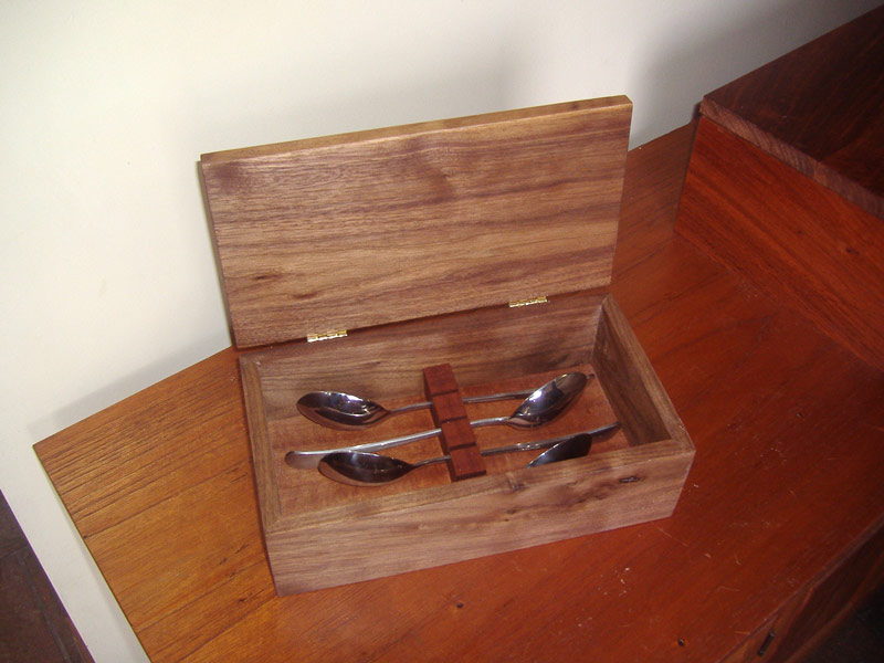

              Hi all,
              I'm afraid I don;t understand the need to stain Walnut with walnut.

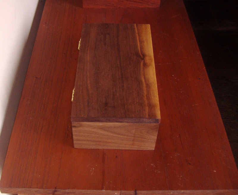

              I use Wattyl Scandinavian oil and wax as a finish. I friction seal the oil as follows.
              dry sand the piece using 80,100,150, 240 and 400g, saturate the pice with oil, then wet sand (the oil is the "wet" through from 400 to 1500 or greater grit. Then allow 24 hrs to dry and wax.
              This little walnut box was done this way. As was the Blackwood table I posted under "some of my projects" in the projects thread.
              Regards,
              Rob
