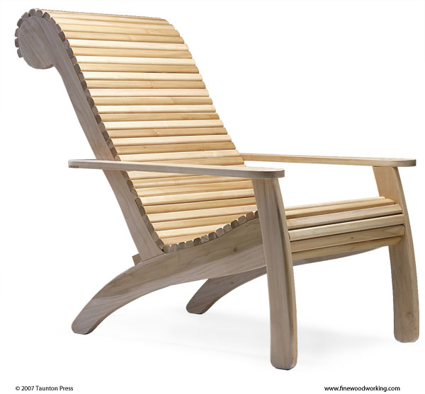

              They are cheap as in $10 for 100 9' x 1 5/8" x 5/8" strips
              I have been planning on building an Adirondack(ish) chair similar to the attached anyway. I was planning on cedar, but cherry would look really nice I think. I don't know if I would laminate the strips for the legs/sides or just use solid wood. 5/8" is a little thin for the slats, but I think they would still work well, provided they don't have to be planed down much.
              Of course, I could also use them for face frames, edge banding, and laminate them together for ... well, I am not sure yet! I am thinking that a slatted outdoor table might be really nice too.
