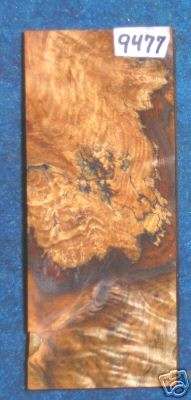

    I bought a 4" x 4" x 12" block of spalted maple off of eBay.

        It was actually advertised as a block for turning. I am not shocked that it was not dried, I figured it would probably be green, but I didn't expect it to actually be damp!
        In the picture, a wetting agent of some sort was used to bring out the figure.
        I bought it more as an experiment than anything else. It really does have some nice figure, so if it works it will be very well worth it. If it doesn't work, I guess I will be a bit wiser.

          Normally, for photos, only a light misting with water is required to highlight the grain and color, and it dries off almost immediately. If the seller soaked the block to get a picture, then he's an idiot.
              I am confident that is not the case. It is green, not waterlogged.
