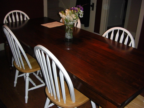

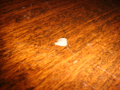

          Here are pics showing full-length view of table and close-up of "pockmark":
          Jeff

            From an antique/collector perspective, it might be taboo to refinish it, but from an owner/user perspective I definitely would.
              If you have ever watched the way David Marks does inlays you could use a similar technique to patch this.

                I would like to just fill in the pockmarks, go over the "old finish" with steel wool, then add another coat or 2 of finish. I'm just not sure what kind of finish.
                I'm guessing shellac because it gets watermarks with just about any water exposure, which usually go away with time. A couple of times hot dishes have been placed on towels which have led to persisting dulling of the finish.
                On the other hand, maybe I should just rub in some more Old English scratch cover? Then I can put off a decision for awhile...
                Jeff
