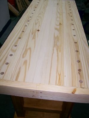

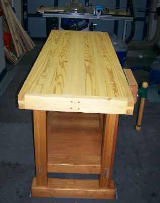

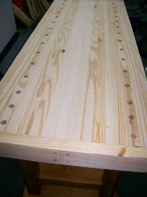

    I built a top two week-ends ago and used dowels as you mention with the exception that I did not glue the dowel into the top bottom and depend on gravity with my top built from SYP. It's kind of heavy and doesn't need the glue.

                      I'm not sure what you "read".. and it probably is irrelavant in this case anyway![snip...]
                      See how easy it is? Just keep drilling holes up and down the table top till they line up.
