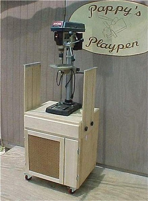

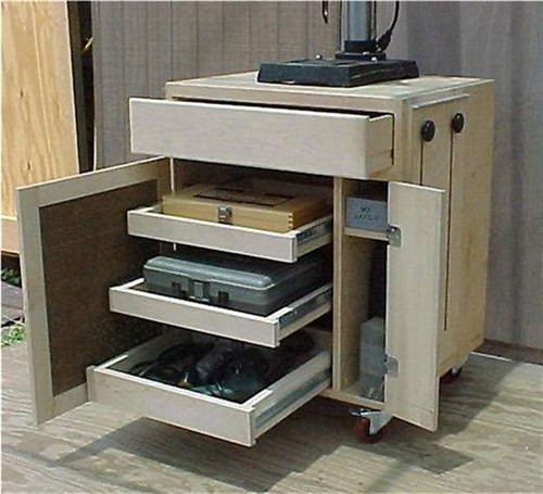

      I used a very basic kitchen/utility cabinet that HD was clearing out a few months ago. I added a piece of plywood to the bottom to attach casters to. 5/8 piece of ply to the top which allowed me to mount the DP. Works well, and I have less than $20 in it.
        Check out the Rod Kirby example.
        http://www.bt3central.com/showthread...ht=drill+press
          My version from bits and ideas taken from several other examples.
Name:	DP Cabinet.JPG
Name:	DP Storage.JPG

            Thanks JR, I looked for Rod Kirby's but only found his floor press version.
            Pappy, I think you hit the nail on the head. Lot's more storage space than my original thoughts and I like the wings.
            Has anyone had any problems with stability? The Shopnotes design has a "sandbox" in the base. The compressor should keep the CG low though.
              Almost exactly what I did. Cept I got my cabinet on clearance at Lowes. And it was a bathroom vanity cabinet. And I used 2x4's to create mounting points for the casters. I had to attach a back to it (used mdf). And I used a "scrap" countertop to make the DP mount.
              Very happy with it. I like the sandbox idea to lower the CG though. Might have to borrow that.
