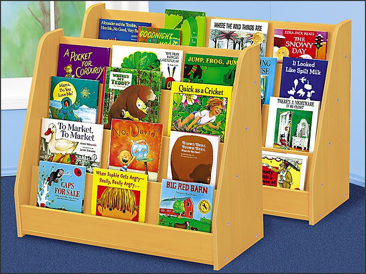

Looking for a plan to build something like this ...
  • BadeMillsap
    • 868
    • Bulverde, Texas, USA.
    • Grizzly G1023SL
    ... for my daughter's classroom
    I searched all the places I know to look for "book rack", "bookcase", "magazine rack" ... but never found anything that would describe the actual "shelving" design of something like this ...
    Thanks for any pointers, diagrams, thoughts, brick-bats ...
    Bade Millsap
    Bulverde, Texas
    => Bade's Personal Web Log
    => Bade's Lutherie Web Log

    Search for magazine, book or video tape display. I found a few things that way, but didn't have time to dig deeper in the links. I think the keyword is display.
      Looks like a fairly simple construction. 1/4 and 1/2" MDF should work well and it will take a good paint finish. Glue and pins should hold it together with maybe a rabbet and stopped dadoes for the shelf bottoms.
        I would also grab a tape measure and hit your local library. I am sure they would be happy to see someone getting kids to read.
        Otherwise, I do agree, the ones I have seen are more of a magazine display rack.
        • just started
          • Mar 2008
          • 642
          • suburban Philly
          You could also try something like this using 3/8" and 1/2" for the back supports and shelves, as someone else said. Figure the books as 9" x 12" x 1" thick, decide how many books you want in the unit and size accordingly. I would use 3/4" for the sides and front toe kick and assemble with glue and pin nails. Make sure to run a round over bit on all accessible MDF edges. I worked in a bookstore MANY moons ago and remember having shelves just like this, but made of plywood since MDF didn't exist then.
            This type of display can be made easily. Start by using plain brown wrapping paper that is sold in rolls, like postal wrap, it's cheap.
            Cut off a piece large enough to draw the side view of the rack full size. What's so simple is that each level can be made separately as a back and bottom edge like an "L". Draw on the paper the shape of the end, and the shape of the "L's". They will attach at a slight angle tilted back.
            When the "L's" are assembled, attach them to the ends. A bottom front fascia trim can then be added.

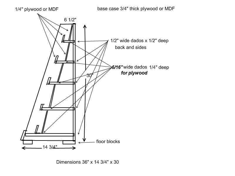

              Thank you all for the replies ... I found this on the net and it helps with your suggestions to give me a good starting place ...
              I'll modify the dimensions a bit but think it is pretty close to what I want and similar to several of your suggestions.
