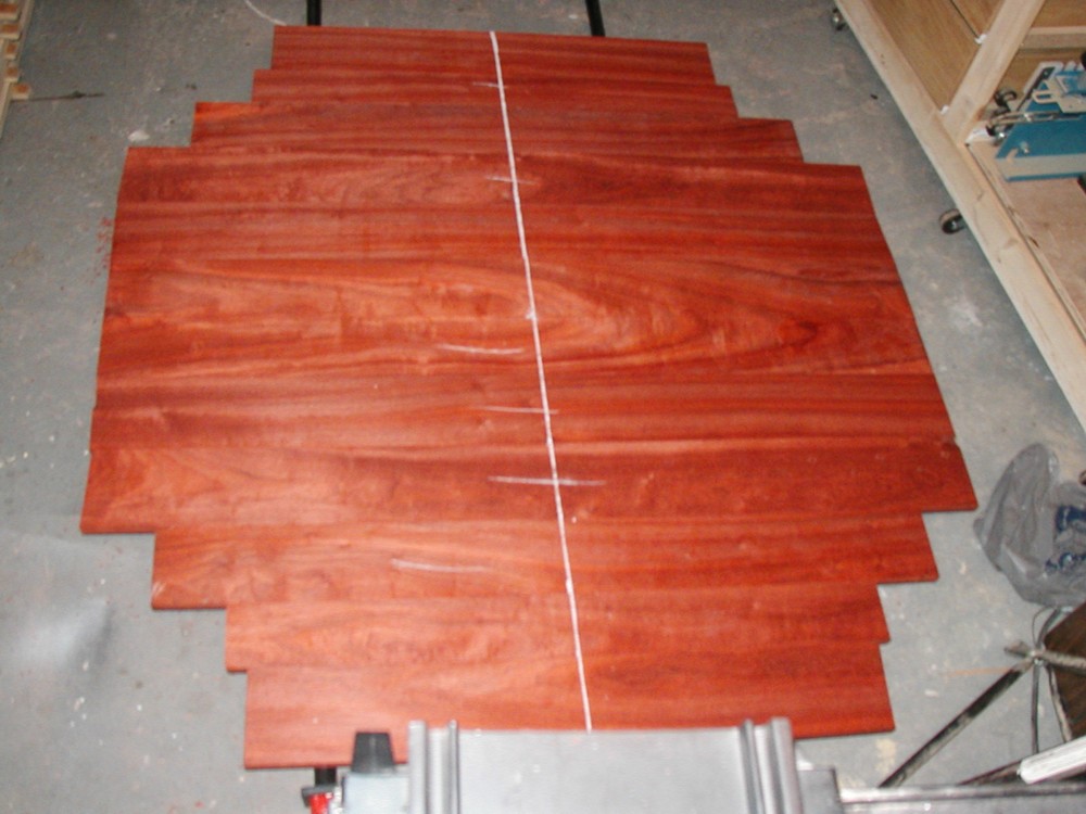

                Photo as requested. I'll glue it up then cut about an 1/8" over. I have a template I made that I'll use with the router to trim the edges to exact size. Then build the pedestal. Probably add some bracing underneath but have to leave it able to move a bit without cracking. This was a dry run to find the center line and work out how the pieces will all go together.
                The small chalk marks are to indicate a board that must go that side up for the best pattern, or a small defect on the other side.

                  Ahhhhh - light goes on in brain
                  Now I understand. I had thought you were creating an Octogon by gluing up triangular or segmented pieces. You are creating a large board glue-up and will then cut out the octogon from that.
                  Given the photo I would do three glue-ups first. The center section and the 2 sides spearatley. When they are dry glue the three panels together. And yes use biscuits to help with the alignment.

                      ... I had thought you were creating an Octogon by gluing up triangular or segmented pieces. You are creating a large board glue-up and will then cut out the octogon from that.
                      Thought the same thing, amazing how pictures can totally change what you had pictured in your mind, and what was really meant my the person.
