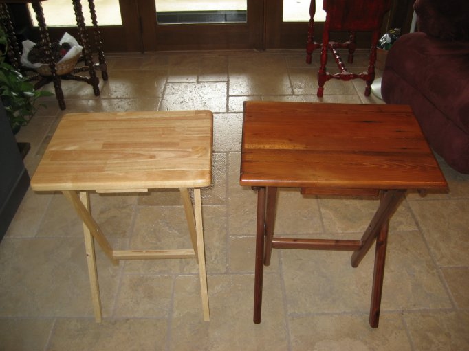

    Hopefully I can get these 3 pictures to show up ... basically I HAVE some wooden TV tray's that I bought a while back but wasn't satisfied with the size of the "table" so I used some redwood I had salvaged from a deck we resurfaced and basically copied the store bought trays into one of what I considered appropriate size ... as for connectors ... nothing special (see pictures)
    Hopefully it is obvious that the one on the left is the store bought tray

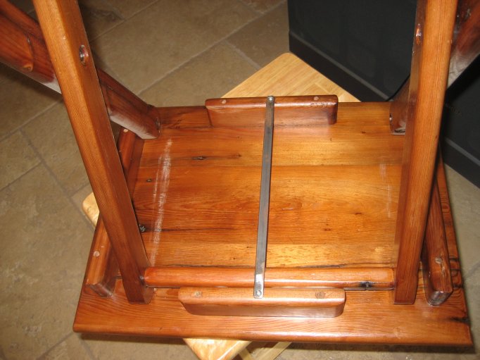

    On the underside you can see (somewhat) how the legs are attached ... it's almost exactly how the "store" ones are done
