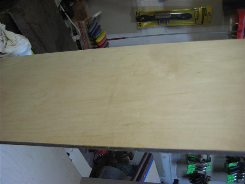

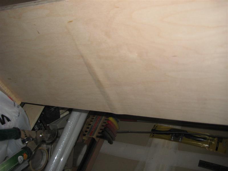

    I decided to try out the borg "maple" ply to make a pair of matching bookcases. I assembled the carcases for both a month back, and haven't been able to work on them since. Yesterday I was out in the garage, and noticed that one of the bookcases was "bubbling" on the both sides, in about the same position. (see attached pics).
    Is there anything that can be done to fix/salvage this? So far the only thing I can come up with is trying some sort of inlay on the side with an interesting pattern...at this point I'm not even all that concerned about having the two bookcases match. They are pretty much assembled except for the face frame and attaching the top. The face frame/edge banding is done in purple heart. Thanks for any suggestions...

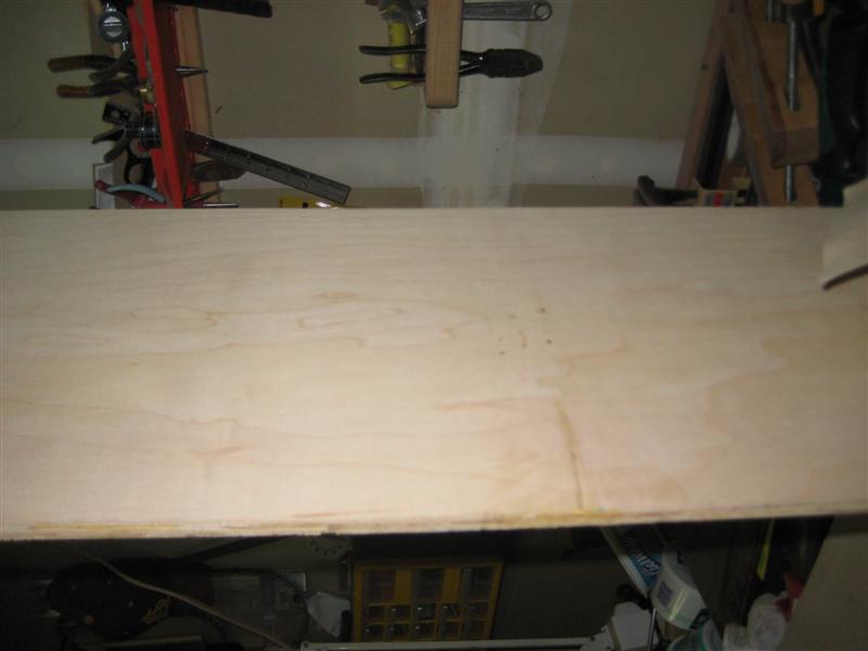

                      update - results
                      i got a chance to try out some of the suggestions these weekend, and pulled off the clamps a couple of minutes ago. the results far exceeded my expectations -- both sides are now flat without bubbles. as you can see, one side is pretty much good as new. the other side has a small split, but that should clean up nicely with some light sanding.

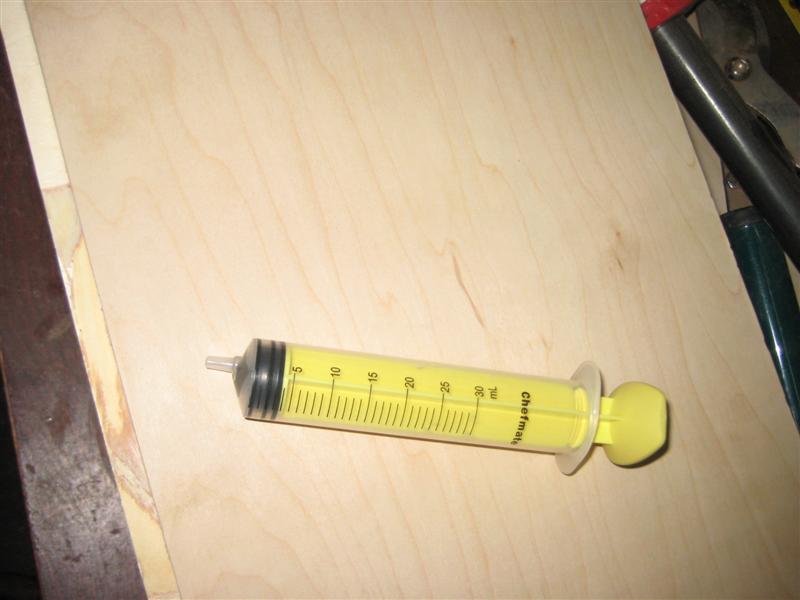

                      I found a "flavor injector" needle at target (syringe missing from the pic) for $2 in the cooking gadgets section. Stuffed as much glue as would fit in the bubble, lightly coaxing it with some low-psi bursts from the air compressor. Then clamped some cauls around the carcase, along with some wax paper, and hoped for the best.
