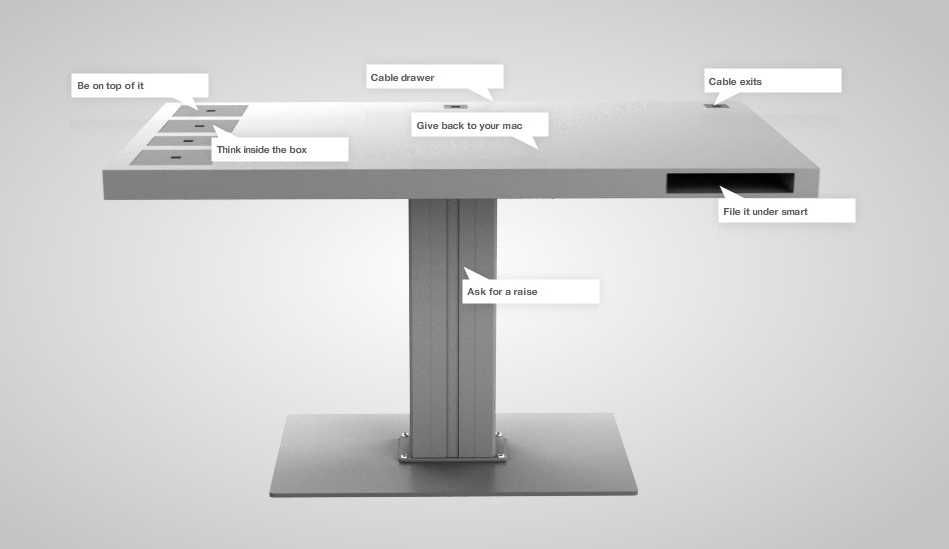

                I found this modernistic table at http://www.milk.dk that makes for good viewing, though not sure I'd be able to achieve that in shop... (it's a screen shot, to get more details you need to visit the site):
                - Aristotle
