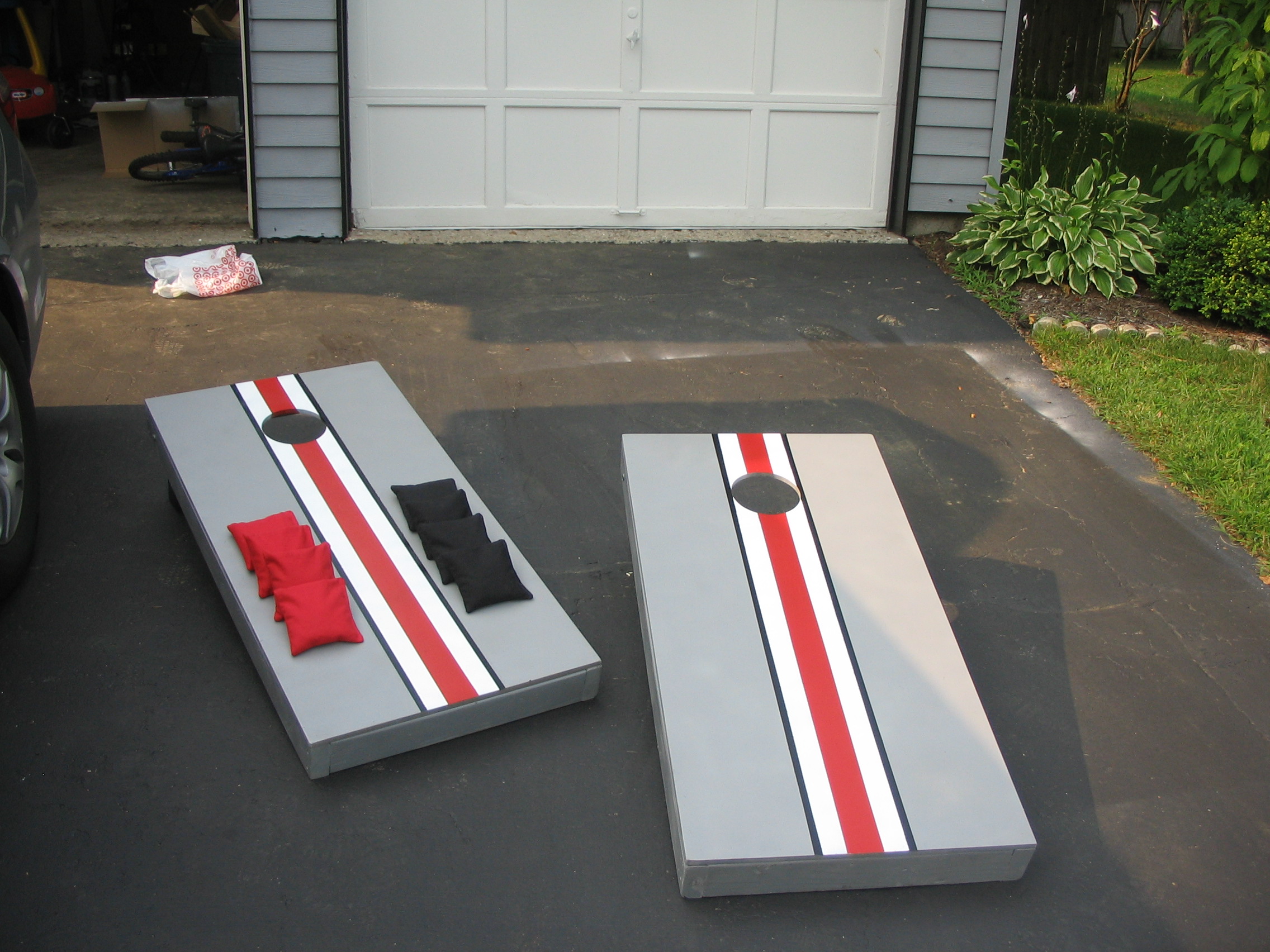

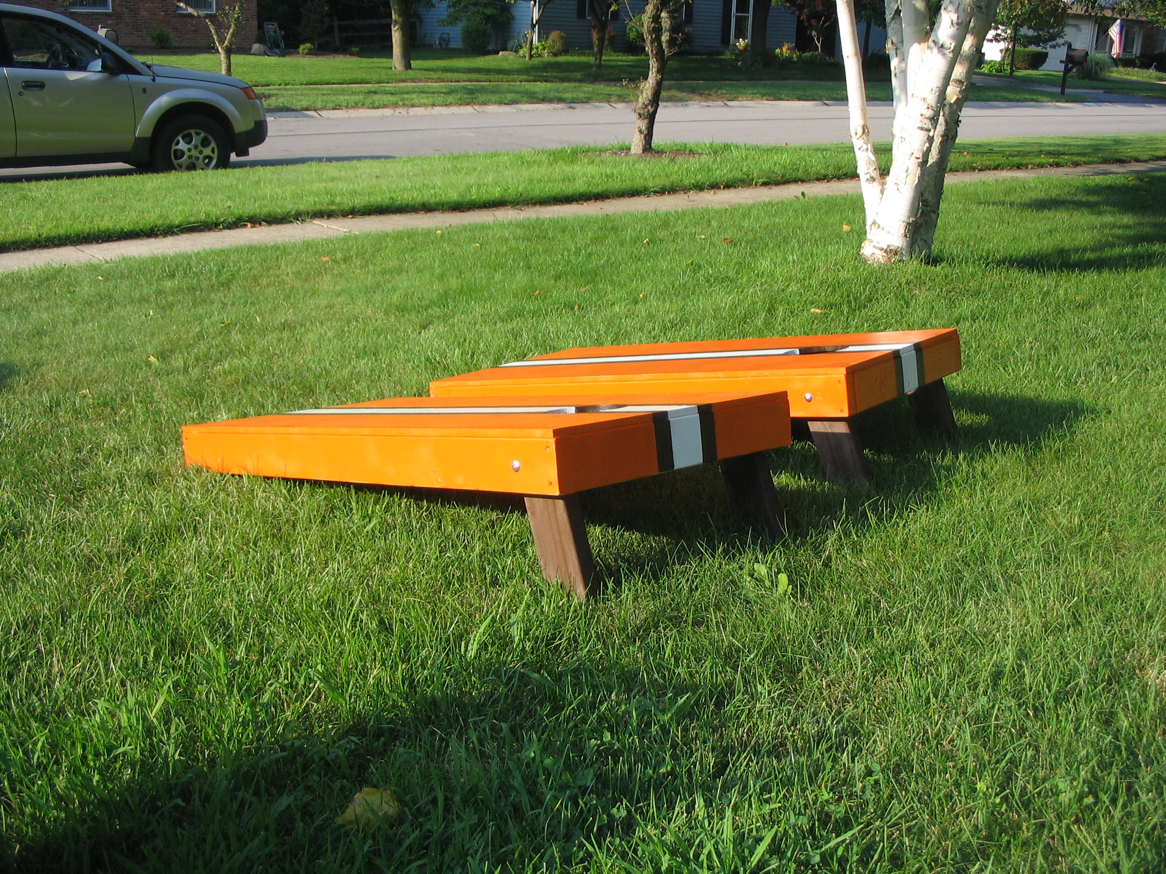

            Here is my set and a Cleveland Browns set I made for someone else. You can see the legs in the Browns set.
            I made a little money making these last year, as the game finally hit the Toledo area. I may make more this year, but I am NOT doing any more custom paint jobs, that was a killer. Building the boards themselves takes no time at all.
            It helps that my mom and MIL are both seamstresses, so they made the bags for me.
            Feel free to PM me if you want any more info.

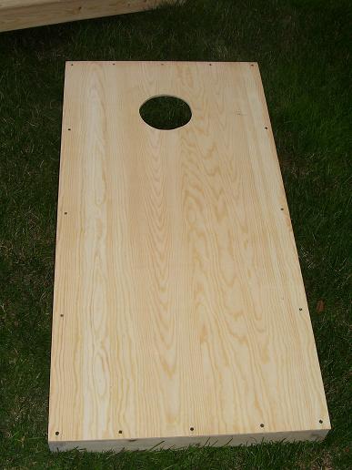

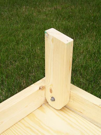

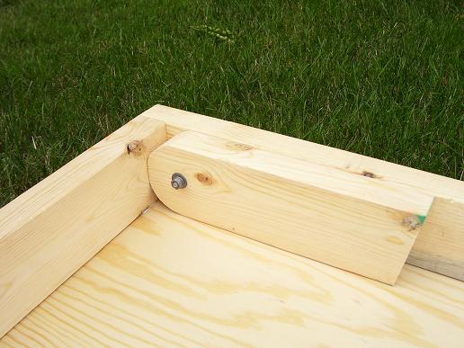

              I've built (and sold) a fair number. I use 2.5 2x4's for each, and 2 sheets of 3/8" sanded birch 2'x4' ply from HD (will use full sheets if I get a circular saw). Its a simple 2' by 4' frame that the ply goes onto, and on the ply, there is a 6" diameter hole, the top of the hole is centered across the short distance, and it is 6" from the top, or 9" to the center of the hole. I make mine with retractable legs, and I did the trig, and they are 11 5/8" long with a 80 degree cut that rests on the bottom. The top has a hole drilled for a 1/4" galvanized bolt with fender washers between the frame and the leg, and a lock washer on the inside (stand washers under the lock washer and the head of the bolt) the top is also rounded around, so it is a half circle that can be rotated into place. The hole is 1.75" from the top, and centered the short way. I think I have pics of this I can dig up.
              edit: pics!
              its not the smoothest round over, just enough that it can rotate, but its not gonna flop around.
              I finish them with thinned poly, all over, especially on the feet bottoms. I sand the top smooth (0000 steel wool on a wooden block or synthetic pads if you want) and then throw a final coat on to get it to just the right texture.
