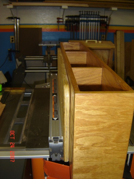

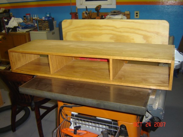

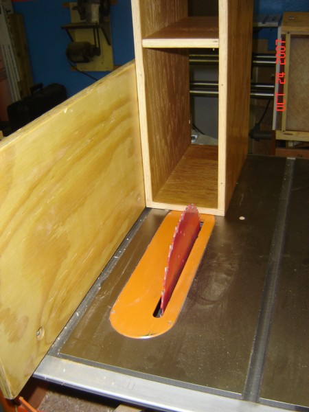

    The first is a pic of the cubby-hole cab that hangs under a full wall cab. I need to remove 1.5" from its height (the narrow dimension). The shop that built it used glue and brads to hold the ends and the partitions to the tops and bottom. I gave it a few taps and the glue joints are solid - I started to split the wood but not along the joint line. The next two pics are how I propose to hand saw the two center dividers first so that when I'm using the tall aux fence they won't be hanging on. I have already spotted two safety issues:
    1.) The fence falls exactly in the middle of the right side miter slot. I worked the cab along that little piece of fence on the infeed side and I don't see an issue but wondered if you do.
    2.) The end pieces are not flat and they wobble a bit from one corner ot the opposite corner. I'm not sure whether I should build up the corners with tape or try to sand them off 'til flat. The second creates the issue that one end is visible and finished.
    OK, have at it you thinkers. TIA!

    After some thinking, I believe that it would be far easier to sacrifice the two middle dividers and replace them with wider, 3/4" material which would cover most of the scars of tearout tear out that is inevitable. I'll have to deal with stain matching but it's probably less of an issue given where they will live.

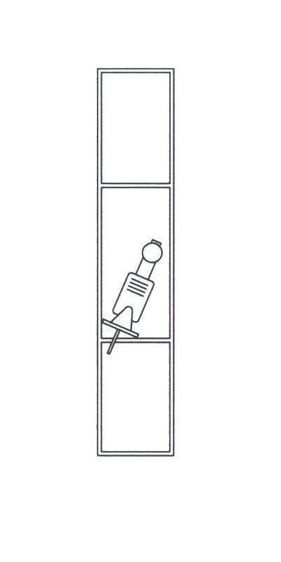

        If you mark the new finish lines on the center dividers, and then cut them off with a jigsaw along a different line (within the scrap area), then you can make the outside cuts on the TS and take the top (or the bottom) off and get in better to make the finish cuts with a circ saw and straightedge. This way, the retained portion of the center dividers can be preserved in place. Then, you can plane down the divider "stubs" from the top (or bottom) you removed, and reassemble.
        Note that you could use the same method (circ saw and straightedge) on the outside ends, as well, if you'd rather not horse that thing around on top of your TS.
        Also, for those times when they're in the way, you can fabricate a filler strip for the miter slots on your TS from UHMW or any number of other materials.

          Yea, Sam, I'm being cheap here because time is an issue and I would have four of these to knock together, although, they are pretty simple. U.Cracker, I just don't see a good way to get a sabre or circ saw in between the ends and the dividers. I smell a weekend project coming on as well as a lost archery season.
            Center section looks a little larger. Sure looks like room enough for a jigsaw to me. The circ saw doesn't happen till the top/bottom is off. This won't work?
