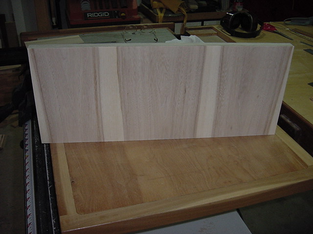

    I am building a desk for my daughter using BB ply for the carcase. I want the grain on the sides vertical, and because of the movement issues I couldn't use solid wood. I planed on covering the sides (9" high 22 long) with grey elm; the grain vertical. I re-sawed the elm and planed it to .150. It takes 3 pieces 7 1/2 X 9 1/2 giving me 2 joints. per glue-up. I did one using TB III and had a rough time keeping the joints tight while clamping. While trying to find a better method, (thinking contact cement) I discovered I could still have movement problems.
    3 questions:
    1 Is this a bad idea?
    2 If not what is a good glue to use ?.
    3 If it is a bad idea what should I do ?????????

        Ohh now it makes more sense. If this is the case either yellow or whate glue is what I would use and no real need to worry about wood movement. It is commonly advised to add the veneer to both sides of the plywood to totally prevent any movement.

          Mike, Thank you for making my post "understandable". Mark Thank you for your response. Since I already have one of the four sides done with TB 3 glue I was hoping that someone would ok this method. The desk is one featured in vol 29 / # 170 Woodsmith mag. I made a small grey elm bookcase for her and now she wants a desk to match. Nice wood to work with kind of like Maple

            Charliex, here is my advise, based on a fair amount of veneer work.
            Glue the veneer cross grain to the exposed plywood grain, and veneer BOTH SIDES. If you do not, you are likely to get warped plywood when you are done. The thick outter shell will absorb moisture at a different rate than the plywood veneer, and expand and contract differently, thus cupping the piece. As for your gap problems, try edge gluing the 3 veneers together using titebond. Use something heavy over the joints to keep them flat while you get just enough clamping pressure to pull them together. Another option here is to use veneer tape to hold them together, it's a water activated tape made for just this purpose.
            Here are my answers to your 3 questions...
            1. Not a bad idea at all, if you cross grain glue on both sides the results should be nice and stable.
            2. Titebond II for edges, then cold press veneer glue for the lamination.
            3. see 1.
            btw, try and get good even clamping pressure across your surface when you do the veneering glue-up. stack mdf (I wax mine), then use cauls across it and lots of clamps.
            Keith Z. Leonard
