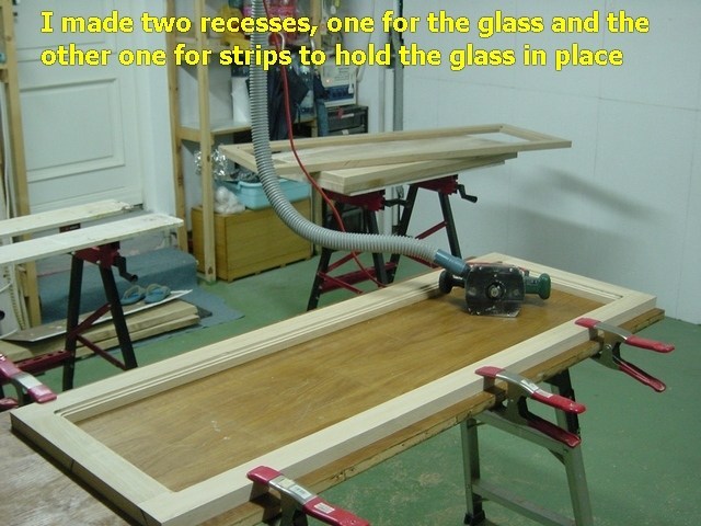

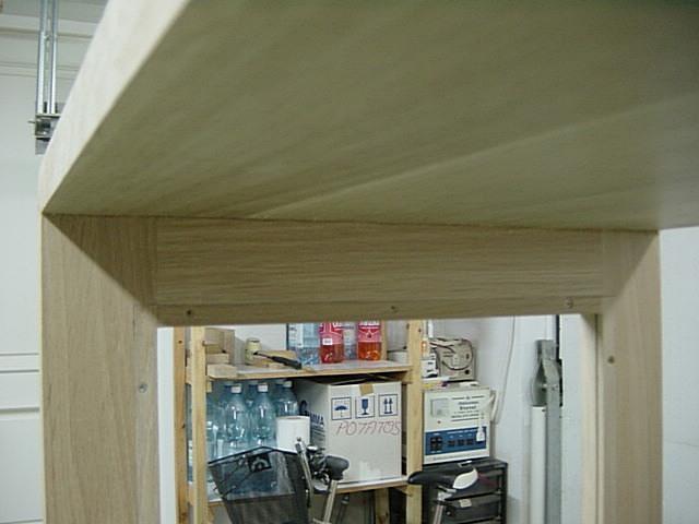

        I like to make it with strips so, in case the glass breaks, the replacement is very easy.
        After staining, the strips and the screws are almost invisible (I stain also the screws heads)
