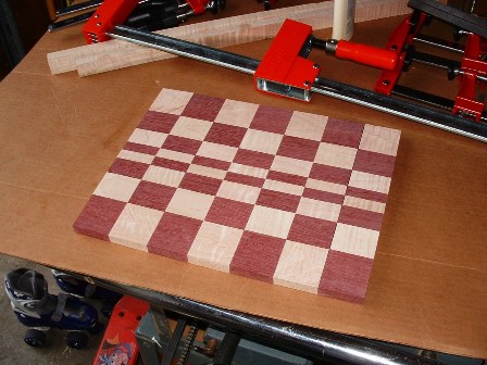

    After watching the pod cast for the Wood Whisperers cutting board, I decided to make two of them for my sisters for thier birthdays. I am making them out of Purple Heart and Curly Maple. Here are a few pics of the surface prep, dry fit and glue up of the first one. Dry fit size is 15.5"x11"x.75". More to follow.......

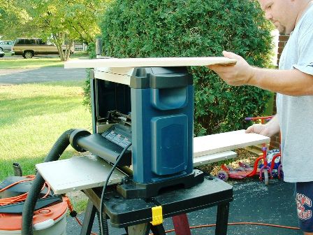

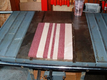

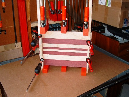

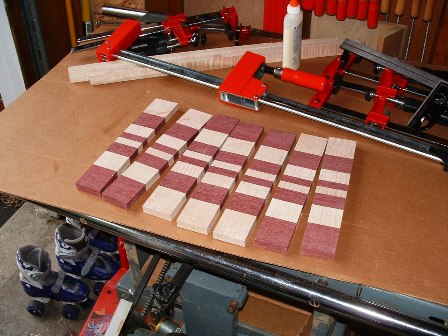

    I removed the board from the clamps and cleaned it up with the planer. I then cut it into 7 strips the same widths. The board was dry fit before final glueing and then glued and clamped.

            Thanks guys for the nice comments so far. As far as the wood I am not having trouble with the Curly Maple, I am having the most trouble with the Purple Heart. It sure likes to slpinter and I have a few stuck in my fingers today.
            I hope to have time to unclamp it and cut into strip tonight to reglue the cross-hatch pattern. I will post more pics when that happens.
