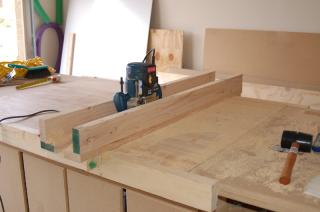

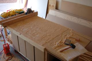

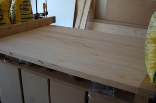

                i used the router technique myself when i flattened my maple top for my work bench. infact the pictures are in the gallery, under footprintsinconc.
                the rails and the sled were scrap 2x4s that i flattened and surfaced before i used it. i used a 3/4" bit on the router. i did the top in two passes because to top of my rails were were just under an 1/8" fromt the top, so the shavings were actually lifting the sled by like 1/16" in spots. at the end i used an orbital sander (5" dia) starting at 100, then 150 and then 220 grid paper.
