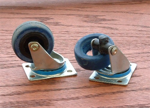

    The total weight was probably around 150# (about 40# per caster) so I thought the casters would handle it. One of the swivels made a liar out of me.
Name:	HF Swivels.jpg

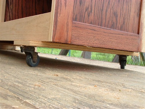

    My solution was to use the rusty 35+ year old Darnell casters salvaged from an old office chair. These are basic casters with hard rubber wheels and no axle bearings. I had to do a temp repair on one with a broken wheel, but they proved more than up to the task!
Name:	Darnell Swivels.jpg
    The rest of the HF casters are going in the trash and the Darnells are going back to the company for proper repair under the lifetime warranty!
