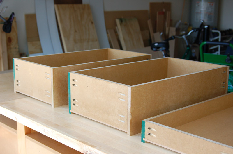

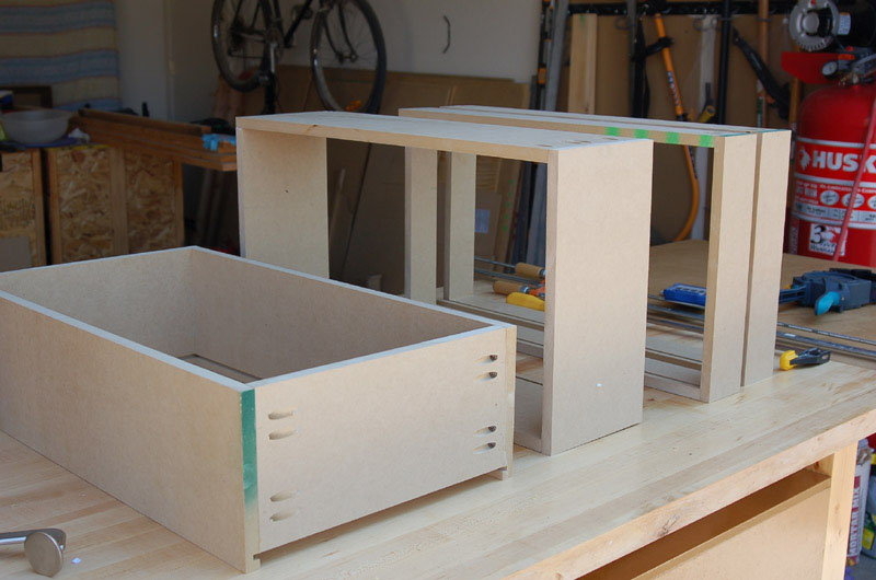

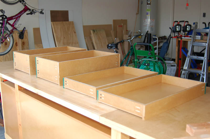

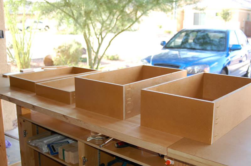

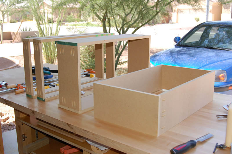

                        build and finished!
                        well things didnt go as planned! i dont know about you guys, but i usually doing other than what i plan, it bothers me alot afterwards
                        i ended up cutting the pieces for pocket screws only and forgot to make the back pieces longer for dados and had drilled all the pockets aswell before i realized what i had done, so i just put everything togather and have also applied the finish. all they need are drawers slides and they are ready to be installed.
                        cabinetman, you are right: after joining the sides of the drawer, i needed to square a couple of the drawers, and all it took was to hold the front, then move the back one way or the other, really flexible - not ridgid as i though it would be.
                        i would love to try out dovetailing, but i'd have to get the jig first, but i have other tools that i want to buy first.
                        well i made them out 5/8"mdf and 1/4" mdf for the bottom so it is removable. i may add some support in the middle at the bottom on the two deeper drawers if needed with time. lets see how they last, time will tell.
                        here are some pictures.
                        edit: oh, writing the post, i just rambled on and forgot to thank everyone for their suggestions. so thank you!
                        omar
