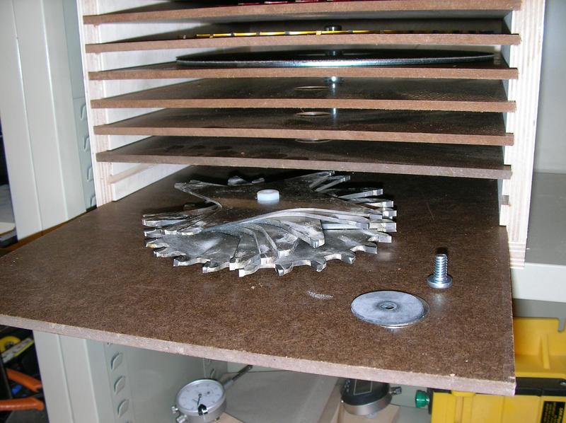

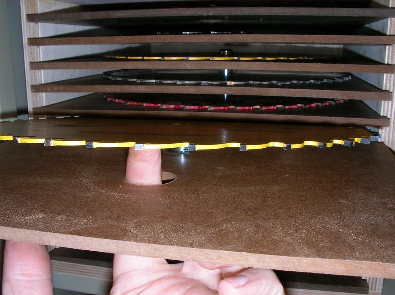

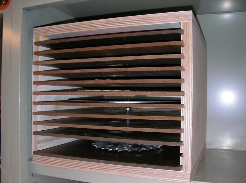

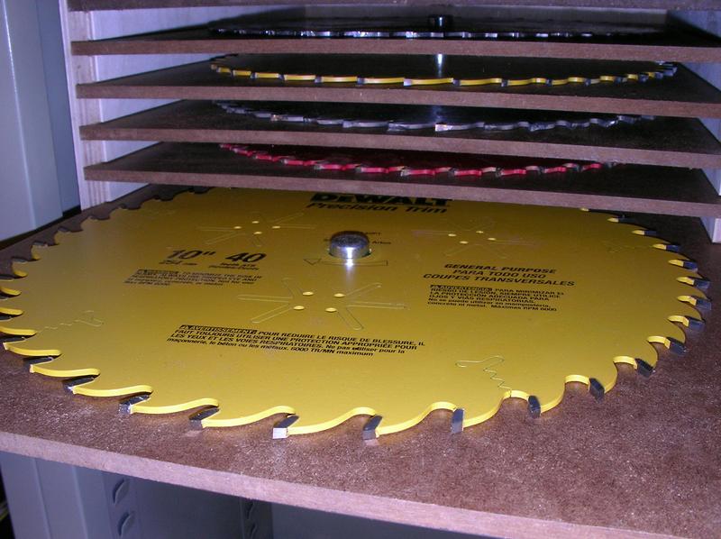

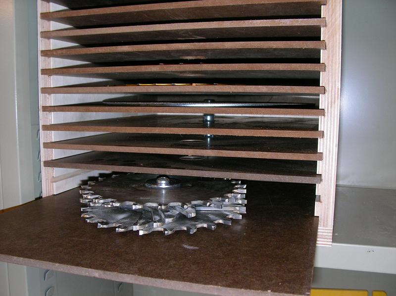

                        Okay, here is my solution. I have a Forrest 6" Dado King that I never use (too much trouble to install). I purchased it before I built my router table. Still, I keep it in case some day I need to make lots and lots dados.
                        I also have about seven or eight blades, and wanted a way to organize those, too. So I built a little blade garage to hold everything.
                        Just a simple BB box made from a bunch of scraps. Blades sit on pieces of 1/4" hardboard that slide into slots in the cabinet. There is 1/2" between each sliding shelf. To keep the blades aligned (so it looks nice) and to prevent them from sliding around if I pickup the entire cabinet, I used some push-on nuts (the kind you'd use to hold wheels on a small children's wagon). I simply drilled a recess in the hardboard using a 15/16" Forstner bit and glued the push-on nuts in.
                        The dado shelf takes two spaces and uses a 1" long spacer from McMaster (#92319A772). This spacer has a hex (minor) width of 1/2", which means it fits the inside of a 5/8" arbor hole very nicely. It is fully threaded (1/4"-20). So I screwed a machine screw through the bottom of the tray and into the spacer. Then I placed a 9/16" fender washer over it, then the dado stack, then a neoprene washer, steel washer, and finally a 1/4"-20 Phillips head screw to secure it all.
                        A couple of other design considerations. I knew the dado set would be heavier than the other blades and may cause that shelf to sag. So I left enough room between the bottom shelf and the bottom of the cabinet so the 1/4" hex-head bolt would just fit and would rest on the bottom of the cabinet--no sag.
                        I also put some extra holes under the blade trays to make getting them off the shelves a little easier.
                        Also, I made it so the blades normally sit towards the front of the tray. But as a blade dulls, I can turn the tray around and then the blade will be tucked towards the back. Once I have a few blades towards the back, I can gather 'em up and send them out for sharpening.
                        Very happy with it. Nothing fancy, but very practical and it cleans up my disorganized pile of blades. Plus I have room for a few more blades.

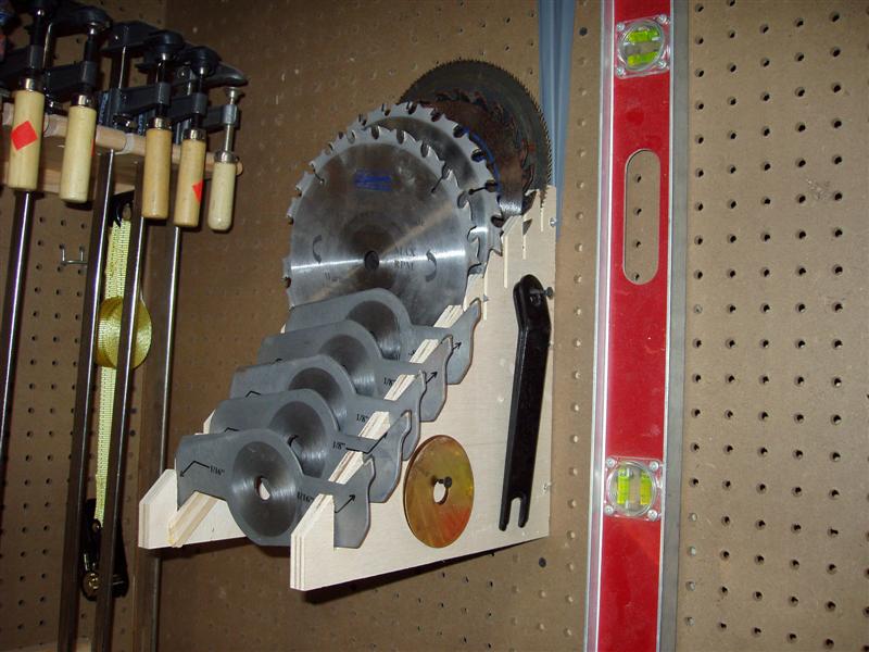

                          • jgscott987
                            • 287
                            • Greensboro, NC, USA.
                            • BT3100 +
                            My saw blade holder...
