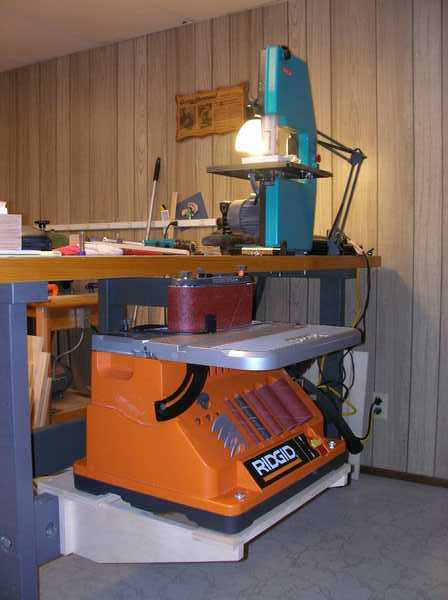

                            Thought I'd follow-up w/ my final solution.
                            No matter how hard I searched, I could not find a tape measure that said this thing would fit under the bench on a pull-out shelf.
                            I finally decided that, since one side/half of my bench is dedicated to the bandsaw, and since I'd be using this thing mostly when using the bandsaw, that I would build a shelf and just hang it on the bench.
                            I didn't want a leg going to the floor (another sweeping obstacle). So I built it with tight dados (and plenty of glue) and used 2-1/2" #10 screws on the "money" joints.
                            I'll have to sit on a stool to use it at this height, but that is okay because that is easier on my back anyhow. Having it sitting out (as opposed to on a pull-out shelf) probably means it will get used more often.
                            The light I use for bandsawing actually stretches to illuminate the work pretty nicely. A bonus!
