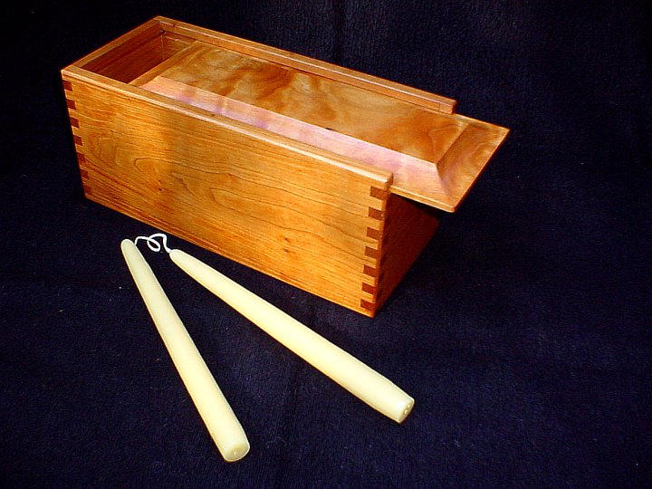

          I haven't made any large pieces with cherry. Cherry may blotch pretty badly. The problems and successes of using cherry will show up more on a large piece, like your bench, than on small pieces like the box that Garasaki made and this candle box that I made for a friend 6-7 years ago. I haven't seen it since it was made, so I don't know how it aged.
          I used natural Watco on the candle box and let it soak in pretty well before wiping off. Multiple coats to a uniform finish. Wiping off sooner may reduce blotching.
          You might also try some fruitwood Watco to add color, or a combination of fruitwood and cherry. NOTE: The "cherry" or "fruitwood" pigment/stain in the Watco may accent the blotching problem.
