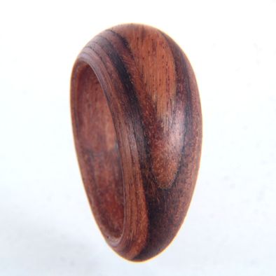

    http://www.simplywoodrings.com/
    Check out the link...He says they are hand made. He also says they are not made on the lathe...
    I am going to try and atempt one...I have started by cutting an inch off the end then boring a hole in a piece of mahogany. I have glued the end back on...then I will mount it on the lathe and turn it. Remove and then sand...
    Anyone have any sugestions?

    the way those look I would think you would need to have a piece of wood with the pith. You would drill out the pith, so that the ring is in reality the rings of the tree. That would be the only way I can think to avoid breaking.
    interesting pieces. Good luck.
    Lakota's Dad
      If it was all one material, I would think a hole saw. Then slowly drill the center out and final sand the interior to size, then slice off that piece (so your drill through has backing).

        I was thinking the same. A small hole saw on the outside and, without moving the blank, a forstner about 1/8th inch smaller on the inside. Again the forstner would likely be removing the pith so your ring has no endgrain to break on.

          I'm thinking they have to be bent wood. If they were based on a "pith removal" method, the grain would run top to bottom with the ring on its side, instead of running around the circumference of the ring. I'd guess he steams/soaks/cooks the wood to get it pliable enough to roll into tubes, maybe even as a veneer lamination, glues the tubes, cuts cross-sections to get rough rings, which he then sands & finishes. The rings in the gallery appear seamless, and if this is how he does it, THAT is an impressive feat! Or I could be entirely wrong. :-)

            He notes that they are made of a single piece, so maybe he take long strips of veneer and as you say, rolls them kind of like an adding machine tape.

              That veneer would have be uber thin to make that radius. I can't imaging it without snapping. And there would be a seam.

                Looking closely at the photos, especially the grain direction, I think it has to be bent-wood lamination.
                My guess is the photos are taken in such a way that the seam is not visible (on the back side). The ones with metal woven around them got to have a seam in the metal too...

                  Well...I tried taking a 2"x2"x5" piece of mahogany and atempting a ring. I started by cutting an inch off of one end on the table saw. I then took the long piece to the drill pres and drilled a 3/4" hole down the length of the block. After doing that I glued the end I cut off back on. After 4 hours of dry time I mounted it on the lathe and then turned it to the desired ring size. I then took the tube to the band saw and cut off about a 1/4". A little sanding...and I had a ring.
                  The grain does not match the pictures...and it is very fragile. I am going to try the steam bending method next week. I'll let you guys know how it turns out.

                    soaking in warm/hot water would probably fix that problem.

                      This one is definitely done w/ veneer. You can see the spiral pattern on the side. I will say that instead of cutting it on a bandsaw, he is probably hand splitting with a froe, and then with a knife, to avoid any endgrain. If he is doing it with a bandsaw, he is using very straight-grained wood.
                      The splitting method is what basket weavers do with white oak, bamboo and other woods.
                        How about this... Wrap a layer of veneer around a form. Then wrap another layer with the seam on the opposite side. Rinse and repeat until the ring has reached desired thickess. That way the seams are opposite each other. I suppose if you could get a single thickness flexible enough you could glue it with a scarf joint or something.

                          Crokett, it's similar in construction then to a drum shell. The seams are varied from layer to layer, but you can still see the seam.

                            My rings are made from a single piece of wood in such a way that structural integrity of the wood is maintained. It can only be made by hand.
                            To me, this indicates it's one long strip.
