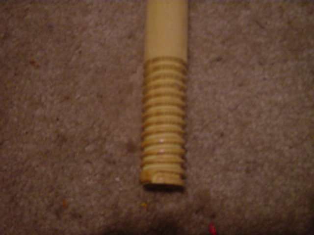

        well i made my first threaded dowel tonight
        what i did was just tap a pc of hedge insted of using the HDPE rod then on my old lathe i made a 1" dowel out of hedge also (hedge aka osage orange)
        i have a pic but cant upload it becouse my youngest son took off with the cord for my computer
        i'll try to upload new pics tommorrow when the LOML finds the cable
        i still have some work to do on it the first 1/2" of threads are not being cut right
        more to come

              sorry guys here is the pic of the first threads i cut using the router jig
              this was a home made dowel i made out of hedge on my old lathe it was 15/16" in dia
              cut really fast took about 15 secs to cut the threads about 4"
              but as you can see in the pic the first course of threads where not cut right i dont know if it was me or the way the jig is taped
              later blame
